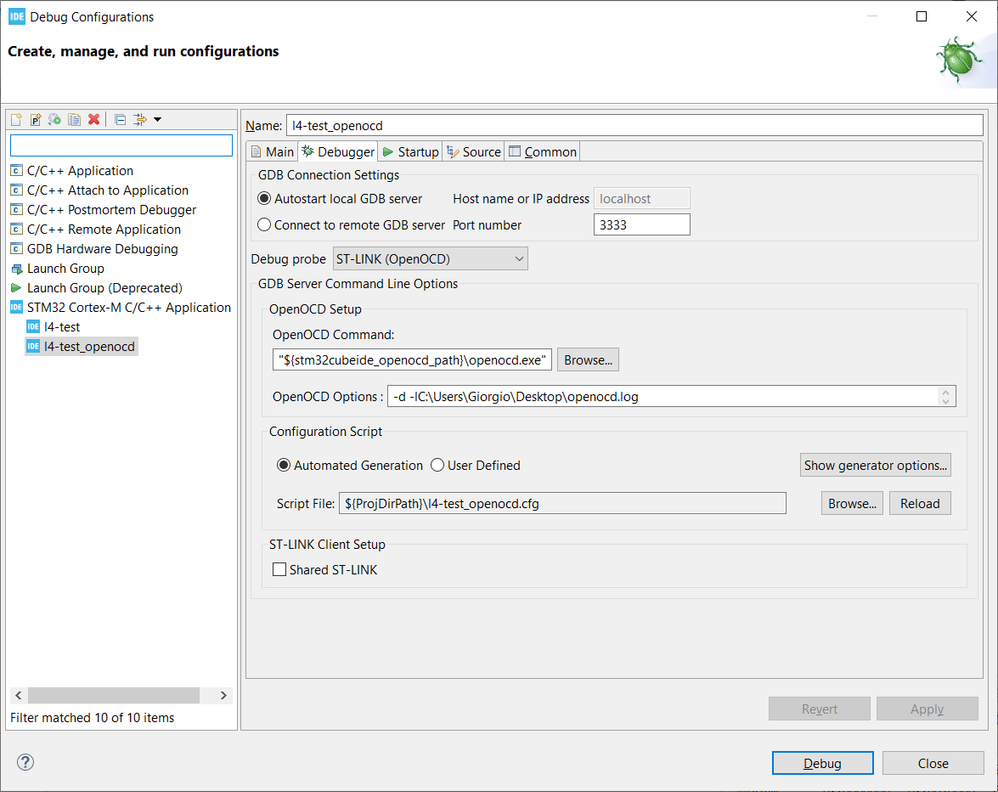

I tried setting up an OpenOCD debug confguration, adding -d and -l options to log the output (see attached image): got no debug at all...
