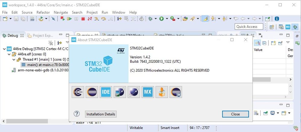

2020-08-17 7:03 AM
On Windows 10, I just updated (again) to the 1.4.2 version, hoping to solve this issue, yet nothing changed.
Already tried a clean install (again) and re-installed the latest STM32CubeProgrammer: nothing changed.
Will ST handle this sooner or later please? Or at least give some help in diagnosing the problem? Thanks

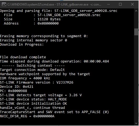

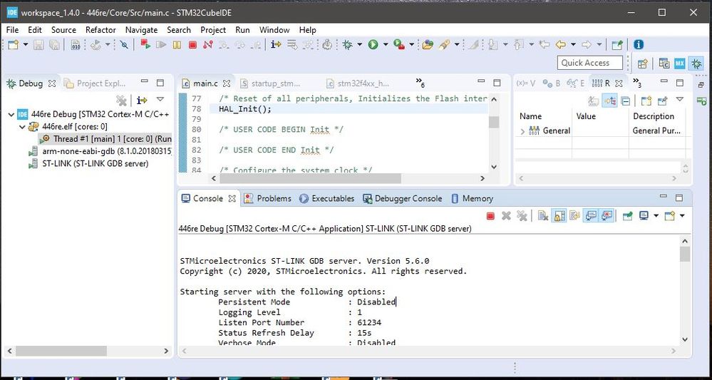

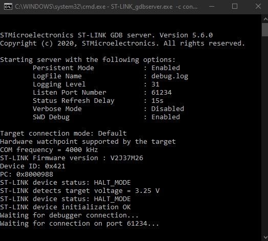

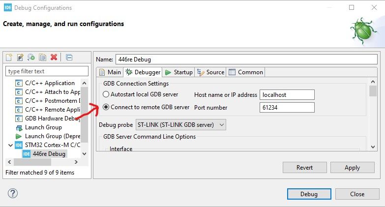

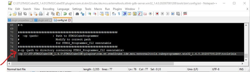

2020-08-25 9:47 PM
this are my temporary solution
2020-08-26 12:17 AM
Hi, sad to hear I'm not the only one facing this issue. If you can, please take some time to do the tests that LaurentL asked me to do, so we can know if it's actually the same issue, and they can eventually fix it: in my case it seems that the libusb (used by the stlinkserver.exe) is not able to enumerate the USB devices...
2020-08-26 8:00 AM
2020-08-26 8:19 AM
Hi LaurentL,
It works! That is great, many thanks!!
Edit: I tested both ST-LINK GDB Server and OpenOCD configurations, for each of them tried shared mode off and on. All works, except for OpenOCD+Shared mode OFF.
