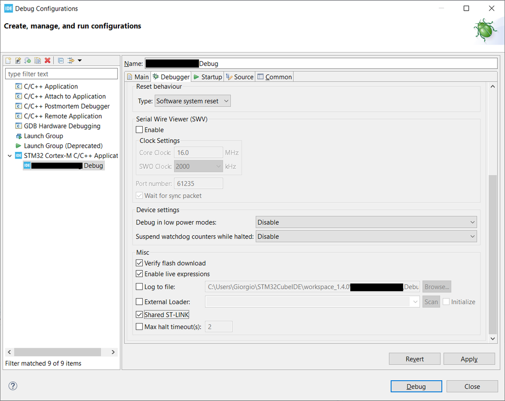

Can you check in debug configuration, with "Shared STLink" option checked that you can see the STLink's Serial Nb.

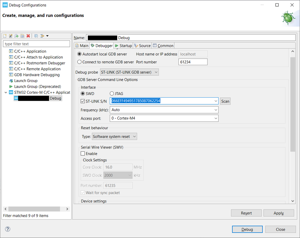

With stlink gdb server, you can click on ST-Link S/N and then scan button and see if the SN text window is populated.

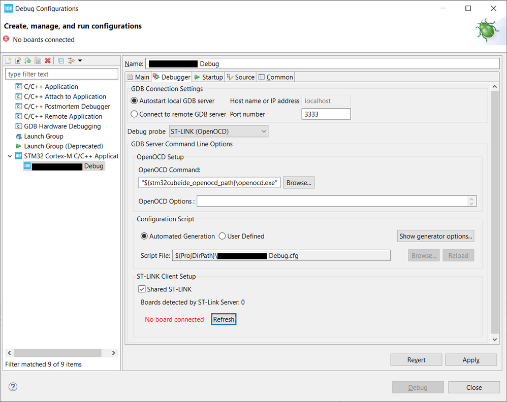

With openocd, you have a window in the bottom displaying all the STLinks connected.

Just checked it now. I tried both ST-LINK GDB and OpenOCD, both times having the "Shared STLink" checked.
ST-LINK GDB: I can see the serial number, but can't start the debug session.
ST-LINK OpenOCD: as I click the scan button, no boards gets detected, and the debug session doesn't start either.
