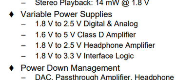

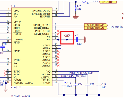

The voltage indicated is the power supply of the PWM output stage of the codec.
You need to read the datasheet of the Codec:
The power supply of the codec is 3.3V for this disco board:

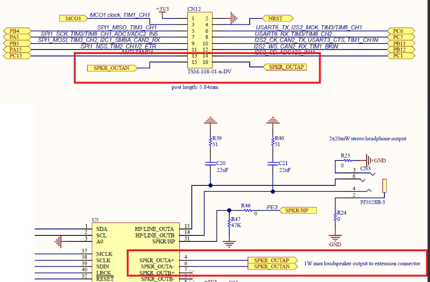

@ashutoshr wrote:so what voltage value is provided by the pins 15 & 16, I have to get it clarified from the Cirrus logic people and accordingly decide on the power and ohms?
See the schematic posted by @mƎALLEm earlier - it shows you that CN12 pins 15 & 16 are directly connected to the Cirrus logic SPKR_OUTA+ and SPKR_OUTA- output pins:
so these are solely a function of the Cirrus logic chip - nothing to do with the Disco board or STM32 microcontroller.

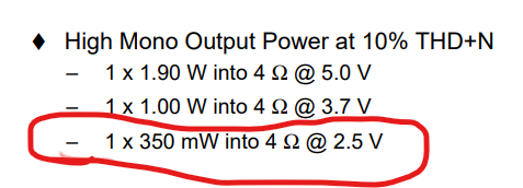

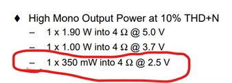

I mean that I understood so only I have asked since the PWM of cirrus logic is powered by 3V3, I should then consider only 2.5V as 3V3/1.414 is roughly 2.3V rms..so while choosing a 4 ohm speaker I have to choose a speaker that is rated say 0.5W then the speaker will be safely driven.
Have I understood it correctly now or am I still messing this up(sorry if I am, please help me)
2024-09-15 11:13 PM
since the PWM driver of cirrus logic is powered by 3V3, I should then consider only 2.5V rms as 3V3/1.414 is roughly 2.3V rms..so while choosing a 4 ohm speaker I have to choose a speaker that is rated say 0.5W then the speaker will be safely driven. Is my choosing of the speaker correct
