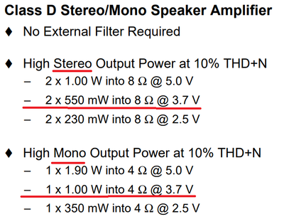

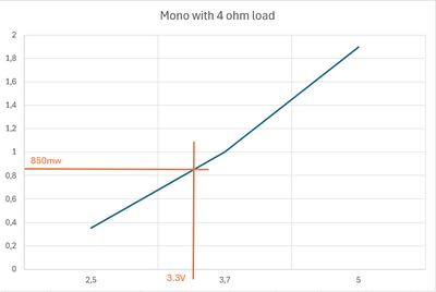

if I connect a 4 ohms speaker, rated with a power of 1W, I can safely drive the speaker using only STM32f469 since it has a audio codec integrated.
According to the following graph I dressed which is based on the data of the datasheet, you can connect 4 ohm speaker but at 3.3V you cannot exceed ~850mW (by interpolation).
In any case, you need to contact Cirrus Logic for confirmation as its the IC manufacturer: https://www.cirrus.com/support/
Hope I answered your question.

Hello @ashutoshr and welcome to the community,
This something related to the codec itself so need to refer to the CS43L22 datasheet.
According to its document:
For more details you can contact the Codec manufacturer "Cirrus Logic".

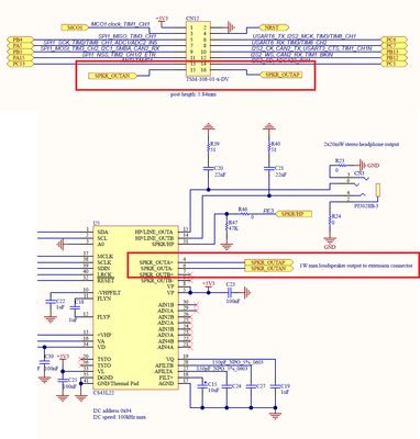

2024-09-12 2:12 AM
He's talking about the on board audio codec output:

No. STM32 doesn't have Audio DAC (only regular DAC) but some boards have audio codec on board as STM32f469-Disco board. For this board, it's the CS43L22 from Cirrus Logic. Some of its outputs are mapped on CN12/pins 15 & 16.

Oh so, since this STM32 disco board is already having a Audio codec, I can directly plug in the speakers to the mentioned pins(CN12- pins 15 &16), and from the Datasheet you have shared earlier, I can see that I can connect a 4 ohm speaker having a rating of 1W, one small clarification I have you have underlined those 2 details because the voltage provided on those pins are 3.7V (which gives the Vrms to be roughly 2.5V, right) ?
So, in conclusion if I have understood it rightly, if I connect a 4 ohms speaker, rated with a power of 1W, I can safely drive the speaker using only STM32f469 since it has a audio codec integrated.
Thanks for your quick response
2024-09-13 12:35 AM
I stand corrected. Thanks.
2024-09-13 1:07 AM - edited 2024-09-13 2:33 AM
