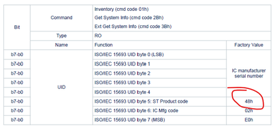

Is it possible to understand the TAG variant from the UID during the inventory ?
For example, ST25TV16K has the UID as shown below:

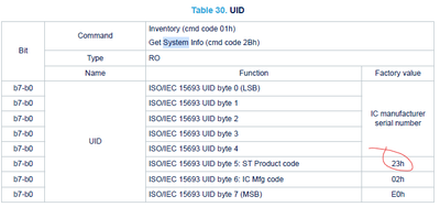

For ST25TV02K, the UID is as shown below:
If you see the above snapshots, ST product code is 48h for ST25TV16K and 23h for ST25TV02K. Are these values fixed and can we identify the tags from the product code ? Is the product code 48h same for ST25TV64K also ? Could you also please tell what does the IC Mfg code say about the tags ?

Yes, you can identify the tag from the Product Code byte in the UID byte 5.
This byte is fixed for each type of tag. Its goal is exactly what you want to do, which is identifying a tag type to know what commands it supports. All devices sharing the same Product code also share the same command set.
You can also use the ICRef to achieve the same goal. Difference between ICRef and Prodcut code is that Prodcut code (when different from ICRef) provides little bit more information and is more "accessible" since it is provided during the inventory.
Product code 48h is for both ST25TV16K and ST25TV64K because both tags are supporting the same command set.
If you need to differentiate between ST25TV16K and ST25TV64K you need to use the Extended Get System Info to retrieve the memory size (which is the only difference between those two versions).
Best regards.
