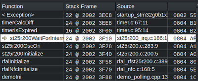

ST25R100 with STM32G0 Freeze in rfalWorker
Mark12
Associate II
I am currently trying to use the NFC09A1 together with an STM32G0. I am having multiple issues.
I am using ST25NFC_Embedded_Lib_ST25R200_1.8.0_2
I setup the platform and SPI. SPI communication is working properly. I checked the signals and I can also properly read the chips ID in the rfalInit.
Basically i am initializing with
rfalNfcInitialize()
and then doing something like this:
    rfalNfcDiscoverParam discParam;
    rfalNfcDefaultDiscParams(&discParam);
    discParam.devLimit = 1;
    discParam.techs2Find = RFAL_NFC_POLL_TECH_A;
    if (rfalNfcDiscover(&discParam) != RFAL_ERR_NONE)
        return Result::Error;
    static rfalNfcDevice* nfcDevice;
    while (true)
        rfalNfcWorker();
        HAL_Delay(500);
On the SPI bus I can see traffic happening And also the Antenna seems to radiate a signal. However, after maybe 5-10 Cycles of the while loop the programm suddenly freezes. I seems that it gets stuck in this loop:
static ReturnCode rfalTransceiveRunBlockingTx( void )
    ReturnCode ret;
    do{
        rfalWorker();
        ret = rfalGetTransceiveStatus();
    while( (rfalIsTransceiveInTx()) && (ret == RFAL_ERR_BUSY) );
    if( rfalIsTransceiveInRx() )
        return RFAL_ERR_NONE;
    return ret;
I am testing with an NXP NTAG215 which from my understanding should be NFC-A T2T, this is also the only configuration that I need working.

I now pretty much copied over the demo_polling.c and ported it. And I configured the Interuppt pin, that I didnt use before. However, Now I end up in a freeze even earlier, in this while loop:
uint32_t st25r200WaitForInterruptsTimed( uint32_t mask, uint16_t tmo )
    uint32_t tmrDelay;
    uint32_t status;
    tmrDelay = platformTimerCreate( tmo );
    /* Run until specific interrupt has happen or the timer has expired */
    do
    #ifdef ST25R_POLL_IRQ
        st25r200CheckForReceivedInterrupts();
    #endif /* ST25R_POLL_IRQ */
        status = (st25r200interrupt.status & mask);
    } while( ( (!platformTimerIsExpired( tmrDelay )) || (tmo == 0U)) && (status == 0U) );
    platformTimerDestroy( tmrDelay );
    status = st25r200interrupt.status & mask;
    platformProtectST25RIrqStatus();
    st25r200interrupt.status &= ~status;
    platformUnprotectST25RIrqStatus();
    return status;

Ok found my main problem. I had not registered the other EXTI Interrupt since my used GPIO uses another one as the example:
void EXTI4_15_IRQHandler(void)
    /* USER CODE BEGIN EXTI0_IRQn 0 */
    /* USER CODE END EXTI0_IRQn 0 */
    HAL_GPIO_EXTI_IRQHandler(ST25R_IRQ_Pin);
    /* USER CODE BEGIN EXTI0_IRQn 1 */
    st25r200Isr();
    /* USER CODE END EXTI0_IRQn 1 */
