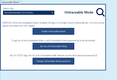

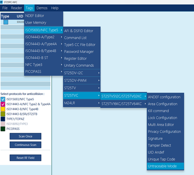

Note: the untraceable mode can be exercised with the ST25PC-NFC. Start the ST25R200 Eval Gui and click on the ST25PC-NFC icon:
Once running the ST25PC-NFC, go to the Untraceable mode menu.
Then, you can toggle the untraceable mode and check its behavior.
