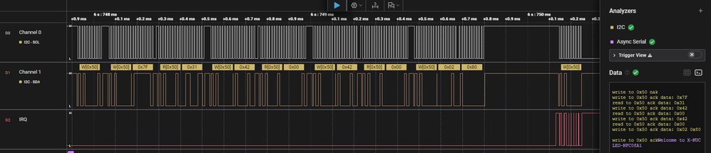

Now I have issues with steps 4 and 5. Maybe someone could give me some advice on this?

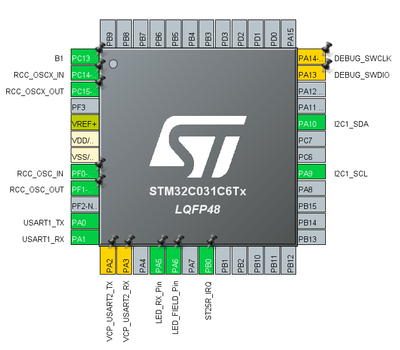

I started with the following wiring:
ST25R3916B <--> STM32C031C6
SDA -> PA10
SCL -> PA9
IRQ -> PB0 (ST25R_IRQ) (as GPIO_EXTI0)
STM32C031C6:
PC13 -> B1
PA5 -> LED_RX_Pin
PA6 -> LED_FIELD_Pin
USART2 - for log

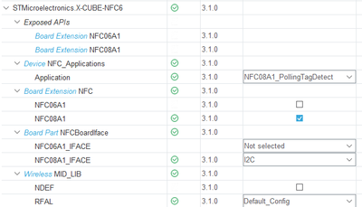

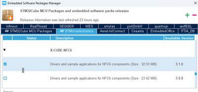

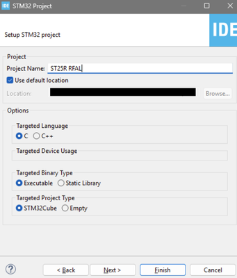

I started with STM32CubeIDE:
File → New → STM32 Project
Selected my NUCLEO-C031C6 board
Created a new project:

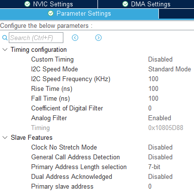

MCU configuration:

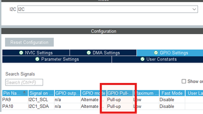

Connectivity → I²C → I²C mode with standard parameters:
GPIO settings for I²C: Enabled Pull-up resistors
I downloaded the STSW-ST25RFAL002 package.

//#define ST25R_SS_PIN SPI1_CS_Pin /*!< GPIO pin used for ST25R SPI SS */
//#define ST25R_SS_PORT SPI1_CS_GPIO_Port /*!< GPIO port used for ST25R SPI SS port */
#define ST25R_INT_PIN ST25R_IRQ_Pin /*!< GPIO pin used for ST25R External Interrupt */
#define ST25R_INT_PORT ST25R_IRQ_GPIO_Port /*!< GPIO port used for ST25R External Interrupt */
#ifdef LED_FIELD_Pin
#define PLATFORM_LED_FIELD_PIN LED_FIELD_Pin /*!< GPIO pin used as field LED */
#endif
#ifdef LED_FIELD_GPIO_Port
#define PLATFORM_LED_FIELD_PORT LED_FIELD_GPIO_Port /*!< GPIO port used as field LED */
#endif
#define PLATFORM_LED_A_PIN LED_RX_Pin /*!< GPIO pin used for LED A */
#define PLATFORM_LED_A_PORT LED_RX_GPIO_Port /*!< GPIO port used for LED A */
#define PLATFORM_LED_B_PIN LED_RX_Pin /*!< GPIO pin used for LED B */
#define PLATFORM_LED_B_PORT LED_RX_GPIO_Port /*!< GPIO port used for LED B */
#define PLATFORM_LED_F_PIN LED_RX_Pin /*!< GPIO pin used for LED F */
#define PLATFORM_LED_F_PORT LED_RX_GPIO_Port /*!< GPIO port used for LED F */
#define PLATFORM_LED_V_PIN LED_RX_Pin /*!< GPIO pin used for LED V */
#define PLATFORM_LED_V_PORT LED_RX_GPIO_Port /*!< GPIO port used for LED V */
#define PLATFORM_LED_AP2P_PIN LED_RX_Pin /*!< GPIO pin used for LED AP2P */
#define PLATFORM_LED_AP2P_PORT LED_RX_GPIO_Port /*!< GPIO port used for LED AP2P*/
#define PLATFORM_USER_BUTTON_PIN B1_Pin /*!< GPIO pin user button */
#define PLATFORM_USER_BUTTON_PORT B1_GPIO_Port /*!< GPIO port user button */Where should I do this? Specify the antenna type and so on?

an STM32CubeMX pack is available for the ST25R3916(B): this is the X-CUBE-NFC6 pack.
Inside the documentation folder of this pack (in <yourhomedir>\STM32Cube\Repository\Packs\STMicroelectronics), the user manual provides step-by-step instructions to configure the MCU, set up the RFAL middleware, and select the appropriate communication interface. STM32CubeMX then generates a ready-to-use demo (polling demo or NDEF read demo).
It is recommended to base your development on the application generated by STM32CubeMX rather than manually integrating the RFAL from the standalone delivery. The standalone delivery is more suitable for non-ST MCUs, whereas the X-CUBE-NFC6 package is specifically designed for STM32 MCUs.
Rgds

2025-09-19 5:38 AM
I have a custom board with the ST25R3916B chip.
And I don't understand whether I should choose "NFC_Applications" or "NFC_Boardface"?
2025-09-22 12:34 AM
I suggest the following:
You will probably have to fake the LEDs that are used on the X-NUCLEO-NFC08A1 as your application uses it's own custom board with only RX and field leds.
Rgds
BT

Many thank you for the reply, I did it and my project compiled fine instead one thing:
I saw an error for the line "USR_INT_LINE.PendingCallback = st25r3916Isr;" in the file "app_x-cube-nfcx.c". So I replaced it with "USR_INT_LINE.FallingCallback = st25r3916Isr;"
When running the project, I noticed that after enabling the oscillator command, the I2C line was disabled, which is very strange, and the project no longer works.
Maybe anyone understand why this is happening?
P.S. An oscilloscope shows that oscillation is turned on at the moment the command is sent.
2025-09-25 7:39 AM - edited 2025-09-25 7:59 AM
possibly a concurrency problem of I2C functions being called from main level and GPIO interrupt - please check platformProtectST25RComm()/platformUnprotectST25RComm().
At second thought likely a interrupt priority issue: ISR of GPIO triggering I2C transfers which in turn requires active systick interrupts. Recommendation:
Prio(Systick) > Prio(I2C) > Prio(ST25R_ISR), e.g. 0 - 2- 5 (the smaller the number the higher the priority)
Weird that the INT pin is not stable at high: Is your VDD_IO stable?
BR, Ulysses
2025-09-26 4:07 AM
Changing the priority helped me move a little further, but not much.
