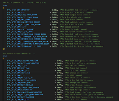

Why does this enum (in rfal_nfcv.h) do not contain the command code for some commands (eg:- Write AFI, Lock AFI etc )? I also do not see an api to do this - If I need to write to AFI, Am I supposed to use directly api rfalNfcvPollerTransceiveReq() with 0x27h command code ?

AFI feature is optional in ISO15693 and not supported in NFC Forum technical specification. The support of Write/Lock AFI can be added in the RFAL:
In rfal_nfcv.h, add the following lines in the NFC-V command set enum
RFAL_NFCV_CMD_WRITE_AFI = 0x27U, /*!< Write AFI */
RFAL_NFCV_CMD_LOCK_AFI = 0x28U, /*!< Lock AFI */
