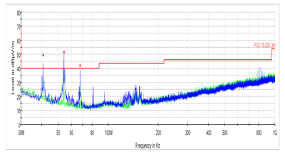

We are running X-NUCLEO-NFC06A1 stack on top of NUCLEO-L476RG board with STM X-CUBE-NFC6 demo software, and the emission scan (at Intertek) is something like this (see below). We cannot replicate the same result in the above FCC report.

In the 30MHz to 1GHz scan data (after page 40), there are multiples adjacent peaks in the band of upper 60MHz to 70MHz (a few are even in 80MHz) range, what are these peaks representing? They are not the harmonics of NFC carrier, and most importantly, we do not see this kind of "wide" band peaks during our test.

The certification tests are not done directly by STMicroelectronics. We rely on an external accredited laboratory for those, because the results are very dependent on the environment (antenna used, anechoic chamber dimension, distance between the system and the antenna…), which needs to follow the FCC requirements. In addition, it is always a complete system which is tested as a reader cannot be tested alone. The system includes the reader but also tags, the power supply, the cables…that can all influence the results (in the past, we saw issues with some power supply)
Hence it is very difficult to explain the differences with your results as different configurations can lead to different results.
