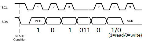

My intention is to just try and receive an ACK bit back from the device to prove that the connection exists. So just for clarity , I need to write devSelCode[8] = {1, 0, 1, 0, 0, 1, 1, 0}; to which slave address ?
2022-11-10 6:49 AM
Actually, what you call the devSelCode is the slave address. It is coded on 7 bits and you have to add the LSB bit to 0 or 1 depending if you want to do a read or a write. This is how I2C works.
Here is the I2C signals with the values you should put in bits:
Best reagrds.
