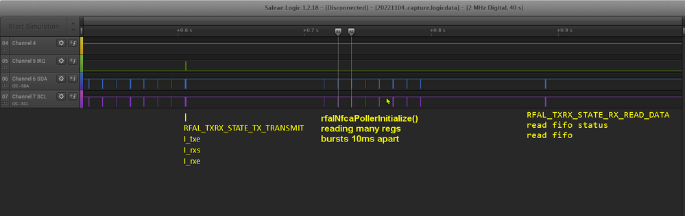

Please analyze/debug the unexpected sequence as per this image:
The question is how does it come to this unexpected call to rfalNfcaPollerInitialize().
I am suspecting that you are calling rfalNfcWorker() not often enough and some timer signals a fundamental problem.
Best Regards, Ulysses

At 3:77ms, I see it read the FIFO status register, which looks like it says only 2 bytes are available. I was expecting more (aren't we getting the UID?). Then it reads 2 bytes from the FIFO, but those 2 bytes don't correspond to what I'd expect. The tag ID is: 04:38:81:EA:F4:73:81
Are there particular error handling functions I could check for in the code?
See attached Saleae trace.
