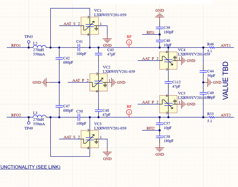

I'm working on a few designs that use the ST25R3916B. I've implemented the antenna match that incorporates 5 variable capacitors based on X-Nucleo-NFC08A1. In one reference design I see that you use the LXRW0YV201-059 but in a different reference design the LXRW0YV600-054 is used. Which is correct?
2022-11-08 11:43 PM
there is no correct or incorrect. The mentioned variable capacitors are different with regards to their capacitance values.
Which one you want to choose will depend on:
Please take also into account that the capacitors have quite a substantial minimum capacitance (typically half of the max capacitance).
Best Regards, Ulysses

Great, thanks. They look pin compatible so we will figure out which to use during testing.
