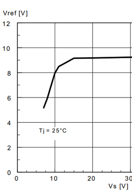

I read from datasheet "10 V external reference available", while I tested 8.8v at Vref by a 12v battery source, could I added an external 10v to this pin?
2024-05-17 1:59 AM
from ds:
So at 12V supply about 8.8 V are exactly what it should be.

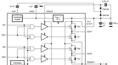

So what does "external reference" mean? does it mean a reference came from outside or it could be a reference for external components?
2024-05-17 3:41 AM
And, I found there is a downward arrow under "external reference" block in block diagram on page 3 of DocID1107 Rev 11(L6234 datasheet), and there is also a downward arrow under each drive gate of the 3 down DMOS, are they connected internally?
2024-05-17 4:27 AM - edited 2024-05-17 4:30 AM
it could be used as reference for external components .
Obviously this is Vdd for the lo-side drivers and the carge pump ; VBOOT is for the hi-side drivers.
