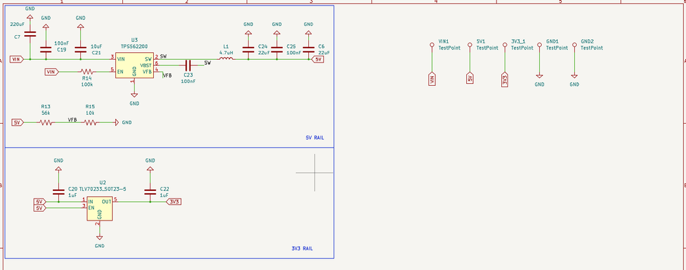

Power measurements:
VDD = 3.3 V
VDDA = 3.3 V (through ferrite bead BLM18AG601SN1D)
VCAP ≈ 1.2 V (2.2 µF capacitor connected directly, ~8 mm trace, no vias)
NRST = 3.3 V
Total board current ≈ 18 mA (two LEDs also present)
The MCU does not heat up, and current consumption appears normal.
Power architecture:
12 V input → buck converter → 5 V → LDO → 3.3 V (MCU supply)
Analog supply filtering:
VDD → ferrite bead → VDDA
Decoupling capacitors are placed near the MCU.

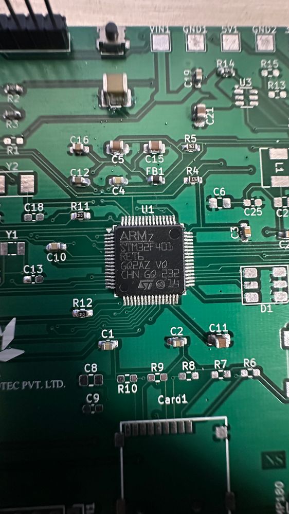

The orientation is incorrect. Pin 1 on the chip is here:
This does not match your pin 1 marking on the silkscreen.

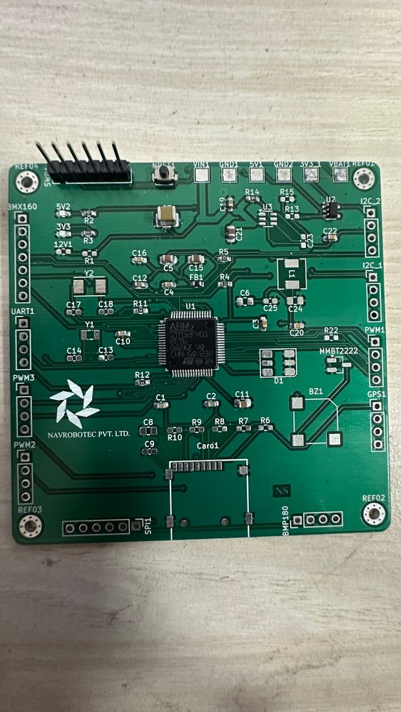

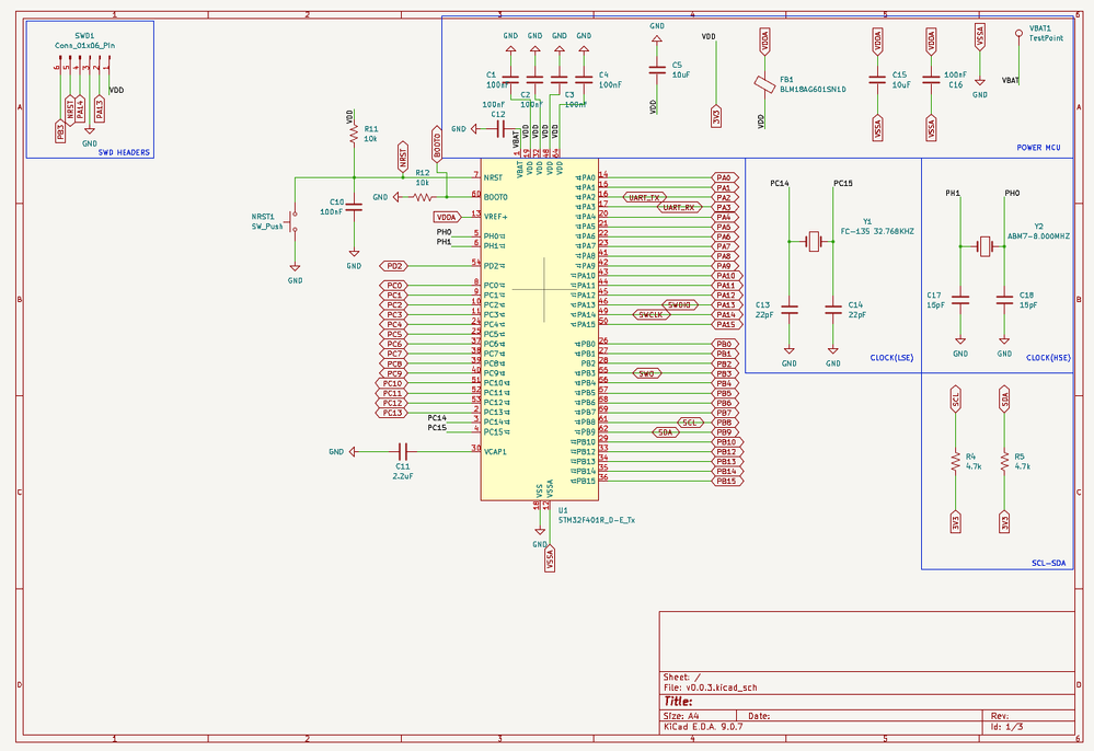

Schematic looks okay. Maybe the part isn't soldered correctly. Show a large in focus picture of the actual board. Maybe orientation is wrong.

Maybe not issue related but why VBAT is not connected to VDD (if you are not using a battery)?

I checked the board again and verified a few things.
All VDD pins measure 3.3 V, and VDDA is also at 3.3 V.
NRST is at 3.3 V as well.
I also checked **continuity between the MCU pins and the corresponding capacitors **, and the connections appear correct. The SWD signals and power pins all show proper continuity to the header and supply rails.
Regarding the earlier VCAP measurement, I likely made an error during the first measurement. After checking again carefully, the VCAP pin is currently reading 0 V.
To rule out soldering or orientation issues, I am attaching clear photos of the actual PCB, including the MCU area and the SWD header, so that the solder joints and orientation can be inspected.

Thank you for the response.
you are correct that it should be connected to VDD if no battery is used. That was an oversight in the original design. I have already corrected it on the board by shorting VBAT and VDD.
2026-03-11 12:03 PM
It worked!!! :party_popper:
Thank you so much for pointing that out. The issue was indeed the orientation of the MCU. After correcting the orientation according to the proper Pin 1 location, the chip is now detected correctly.
