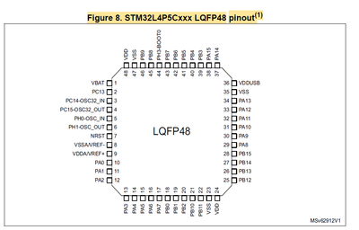

Thanks for reply @STOne-32 and sorry but I´m still confused, I already check that my MCU package doesn´t have a specific VREF+ pin exposed as mentioned here
Then looking at the pinout of my package for 48 pins ( I got confused in previous post and thought it was 64 pin sorry for that)
it shows this on pin 9: VDDA/VREF+ does that mean these power signal are bounded insede the MCU in first place?
If that is the case do I need to place the 1uF capacitor on pin 9?
Note: The recommendation for VDDA pin decoupling alredy include a 1uF and because the VDDA and VREF+ are in the same pin (al least is what I undertood) that means two 1uF capacitors need to be placed on that pin one for VDDA and one for VREF+?
Sorry I hople I explain my self in a better way.
Thanks for your time.
2025-06-01 8:38 AM
Dear @Aldo_Flores_Aguayo ,
in this case , for pin9 you need only 1uF capacitor and another one of 100nF in parallel , nothing else .
Hope it is more clear now ,
STOne-32
