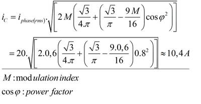

I'm designing an ESC for a drone. I found STM's UM2197 design document. I have a question why this DC link capacitor design uses 2 Capacitors in parallel (P/N 35ZLH330MEFC10X12.5) of Rubycon.
This capacitor has the following parameters:
Ripple Current @ High Frequency: 1.33 A @ 100 kHz
Ripple Current @ Low Frequency: 731.5 mA @ 120 Hz
Capacitance: 330 µF
I want to ask why STM chose this capacitor?
As I calculated, the ripple current through the DC link capacitor is much higher than the ripple current through the selected STM capacitor.
