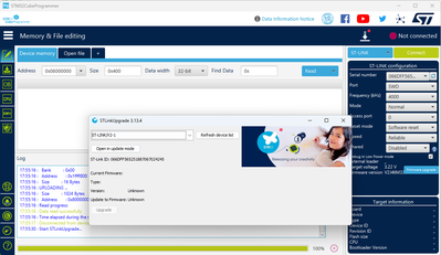

Additionally, I understand that firmware can be uploaded to the STM32g4 via the USB port. However, when I connect the USB cable to the PC, I get a message saying the USB device is not recognized. Do I need to install a separate USB driver?

Firmware writing does not work
When I connect a USB cable between my board and my PC, it shows up as an unknown device on my PC.
I think I'm trying to write the firmware through the USB port connected to the board, but the USB device is not recognized by the PC.
