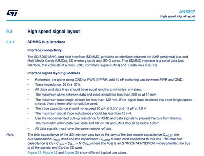

Hello @AT S.1 ;
I think the AN5307 "Getting started with STM32H7A3/7B3 line and STM32H7B0 Value line microcontroller hardware development" application note can help you to start a new design with STM32H7A and to check your schematic.
Also I recommend you to look at SDMMC bus interface signal section for some SDMMC hardware recommendations.
I hope this help you.
Thank you.
