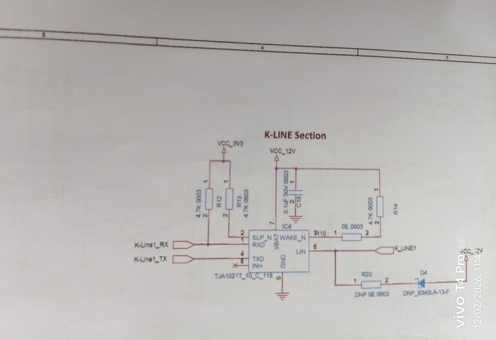

I am working on K-Line communication using an STM32H723ZGT6 controller (EVK board) with a TJA1021T/10/C/118 LIN transceiver. The goal is to communicate with an ECU using ISO-14230 K-line fast initialization.

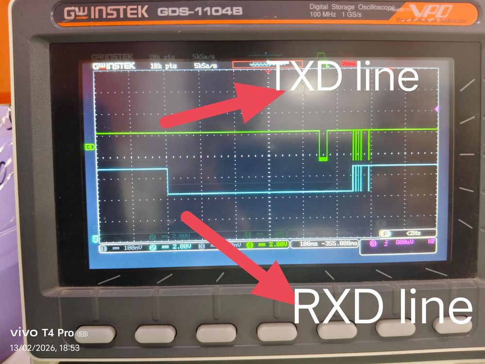

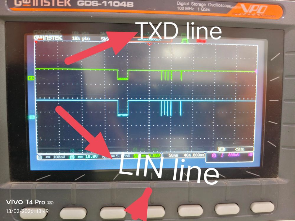

The hardware path appears to be working correctly. We verified using an oscilloscope that:
1.TXD from STM32H723ZGT6 is switching correctly
2.LIN bus shows dominant pulses during fast-init and UART transmission
3.RXD reflects the LIN signal

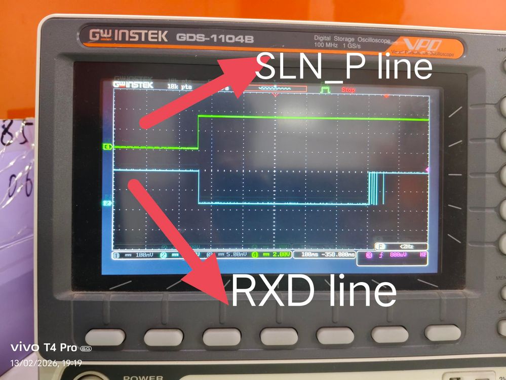

4.SLP_N LOW-to-HIGH transition is implemented after power-up

However, the ECU does not respond — only the transmitted request echo is observed.

here SLP_N pin is connected to controller like gpio to handle low and high through firmware.
