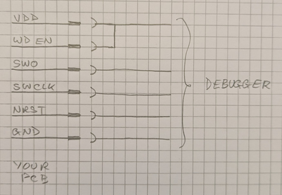

2025-06-24 8:05 AM - edited 2025-06-24 11:14 AM
You need to disable the WD.
You would need to make some custom arrangement in your debug connector to do that.
PS:
For example:
WD_EN pulls the WD /ENable pin high
