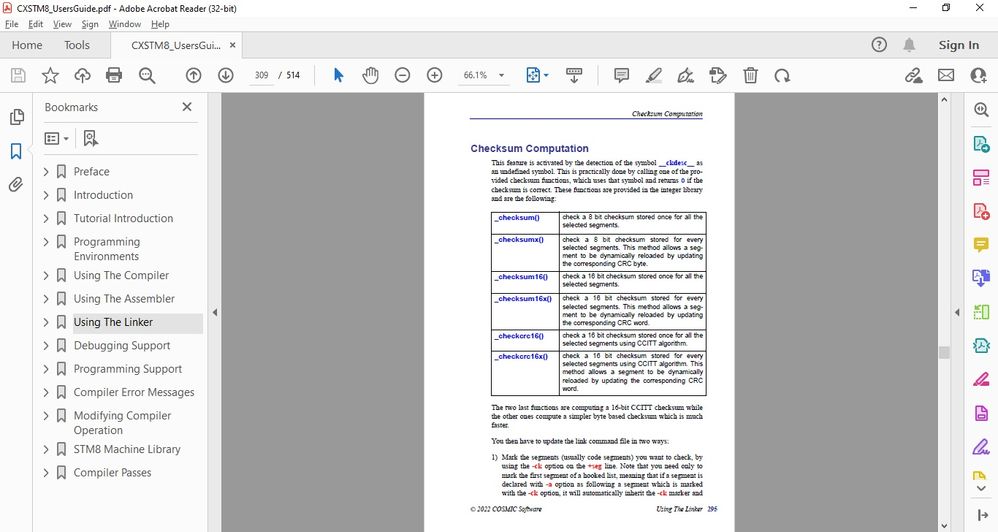

2023-04-30 7:41 AM
https://community.st.com/s/question/0D50X00009XkZBHSA3/crc-ccitt-16-bit-for-stm8s207
Options in the linker settings, check docs on "-ck" option and others
https://community.st.com/s/question/0D50X00009XkY5sSAF/stm8-blockcksum161

https://cosmic-software.com/stm8.php
2023-04-30 10:23 PM
@Community member thanks for your inputs. I will try the cosmic checksum feature on the STM8AF52XX MCU & post an update over here.
