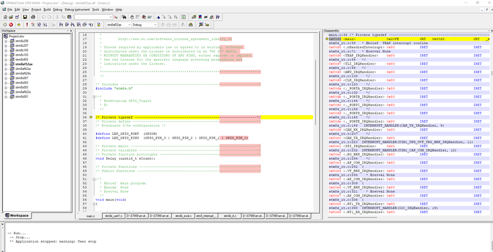

Another problem is my normal program is not working. code is getting compiled but after entering in debug mode it's stopping on line number 36 as show in image. It is not going beyond line number 36
