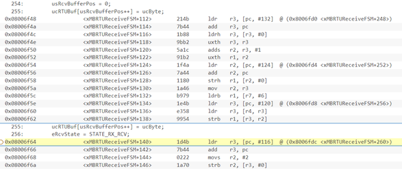

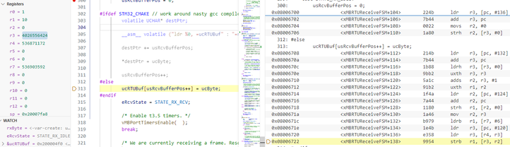

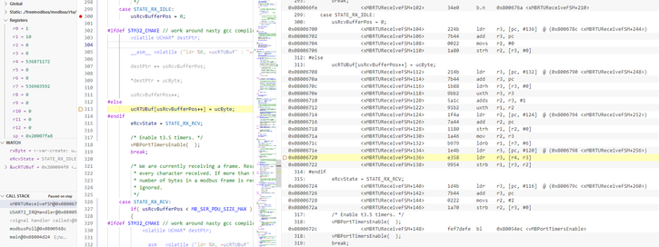

@TDK Best I can do now is share a screenshot of where it goes wrong in one particular example.
The complete project is open source and can be compiled.
It seems pretty clear there is a problem with the generated assembly, which is that r4 is being used without having been initialized:
In the current highlighted line, r4 has a value of 0x20000104, while r3=0.
Stepping through, we get a value of 0xf0006008 in r3:
At this point, the next statement (strb r1,[r3,r2]) causes a hard fault writing to 0xf0006008.
2025-04-29 9:00 AM - edited 2025-04-29 9:31 AM
