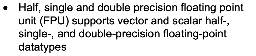

All the tests use intx_t types (x: 8, 32, 64). The only bench that uses double float is the bench_04 (the last one). I verify in the .lst and it uses the fpu and not the soft one. According to the ARM documentation, the fpu ... "FPU with support for half precision (fp16), single precision(fp32) and double precision (fp64) floating-point operations"

yes ...arm doku, what could be in the cpu ....but you have a STM N6xx , so ds N657 says :
So : float , but no double in hardware. Would cost 30 cents more... :)
2025-08-18 2:11 PM
Hi AScha.3,
From the ST data sheet DS14791 Rev 5
