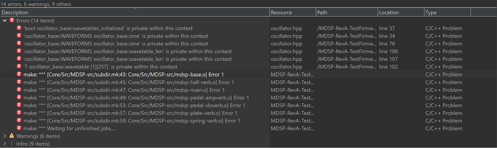

'bool oscillator_base::wavetables_initialized' is private within this context oscillator.hpp /MDSP-RevA-TestFirmware/Core/Src/MDSP-src/dsp-blocks line 37 C/C++ Problem
This is extremely difficult to troubleshoot as it's simply not happening on my machine. Seems like some subtle difference in project settings that isn't getting copied over by git.
In this regard I have two questions:
1. Does this type of error point to any particular cause in project settings we should look at?
