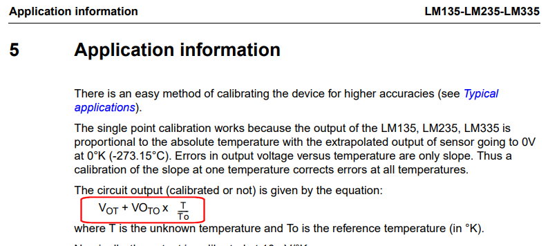

Looking at the Datasheet (DS) of the temperature sensor LMx35, I found that the equation on page 6 is wrong, in the sense that the subindex and '=' symbol are missplaced, and there is no reference of what does each symbol means.
https://www.st.com/en/mems-and-sensors/lm235.html#documentation
I'm pointing this out since I wanted to use this DS with students.

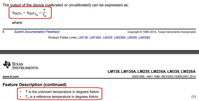

The right formula can be found in another DS from another manufacturer

You mean this?
Indeed, looking at another manufacturer's equivalent:
So:

Sorry, the forum doesn't seem to cope with all that subscripting.
It should look like this:

2024-09-22 10:37 PM
Yeah, correct, exactly that!
