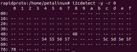

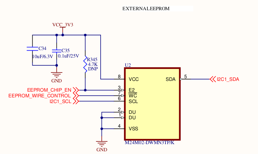

I am new to the EEPROM and embedded.I am having M24M02-DWMN3TP/k EEPROM in my custom board with XCZU2CG Ultrascale Zynq MPSOC processor. This EEPROM is in i2c expander, here I am attaching schematic of EEPROM and i2c devices list on bus 0(I have enabled i2c-expander).
