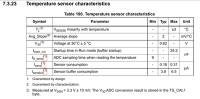

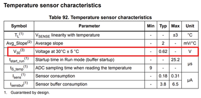

its given in ds ; but need read the TS_CAL + formula in manual:
at 30° : +/- 5° C .
2026-05-01 1:11 PM
S, do you think this can be interpretated as the accuracy at 30°C?
2026-05-02 7:56 AM
As this is the only given range for the temperature sensor value - yes.
And don't forget, this is not a sensor for really measuring temperature, it's more to get some information about the actual chip temperature: is it in acceptable range or not. Depending on actual work load, it could go up or down some degrees in seconds, so +/- 5C is okay.
2026-05-04 11:03 PM
Yes, makes sense.
Thank you very much!
