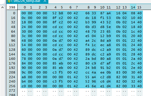

I have the output from MEMS Studio for temperature.  It says the temperature is 32.18C, which is 0x0c90
There is no such hex value in the entire file and so I am wondering how mems studio got the value file attached

This temperature dat problem from the Sensor TileBox Pro has been as hard.  I finally cracked the problem when I was annoyed and playing with the Hex Editor and found that if I clicked on float the blasted answer of 32.18 appeared, three hours later I worked out how to code it in C#.

Clearly the JSON file tells me what to do, but my education is clearly lacking in translating decimal to floats,  I know I should have known that, the tyranny of knowledge is a bad thing.

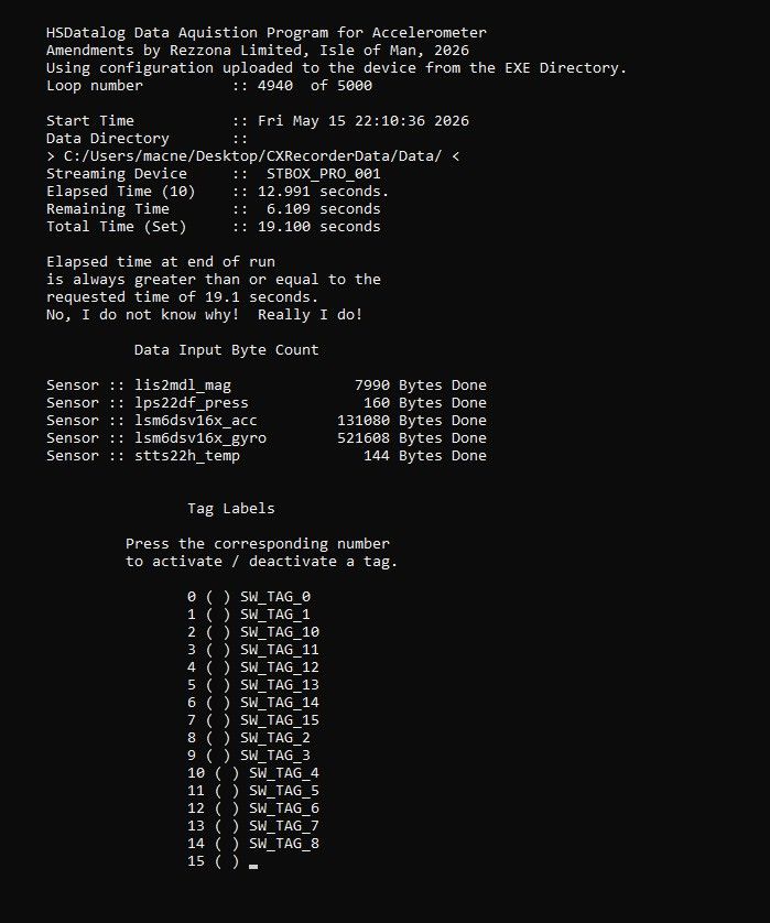

You start the CLI_EXAMPLE Program, which has been adjusted so it loops at 19.1 seconds, yielding two 16384 time signals with a throw away bit.
NB:  If this was a mission critical use the throw away bit is not permitted, but it is a calibration and evaluation run.
So this is the modified first screen, it tells me all I need to know in a glance. I also removed about 200 redundant lines.  I would upload it to github but that is beyond me limited skill set or I am too lazy.  My friends would assume two.

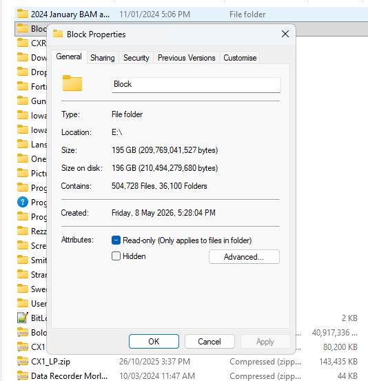

I have limited the run time to 5000, which is about a day, it has been running since 2 Instant, so on three days it has finished, the rest of the runs threw an error in your locked DLL's.  I would ask again for the DLL's but that is a waste of time.
Your data could be analyzed using MEMS Studio, and then you have to write a program to use the MEMs Studio out put, so it is simpler to use a C# Program and just tear your data files apart.   I would much prefer to use the method for the earlier devices and just have one C# program that gets the data, throws up a thread and does the analysis.  The only problem with this program from your early devices is that it will run unattended for a year, a NUC that the program is running on will not run unattended for a year.
The data files start to grow so the CSV and the data files after thirteen days are 195 GB from one device on one brick to calibrate the temperature.

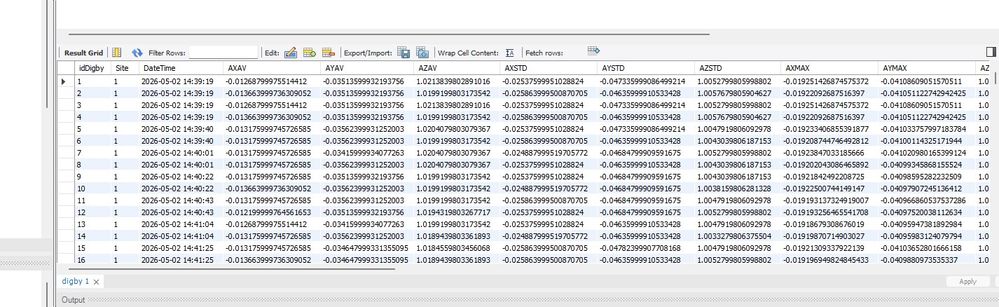

The real core of the results are uploaded to a MySQL data base, it would be nice in the cloud as happens for all the other devices, but this one is just local.
One gets a line of data every 8 seconds or thereabouts.

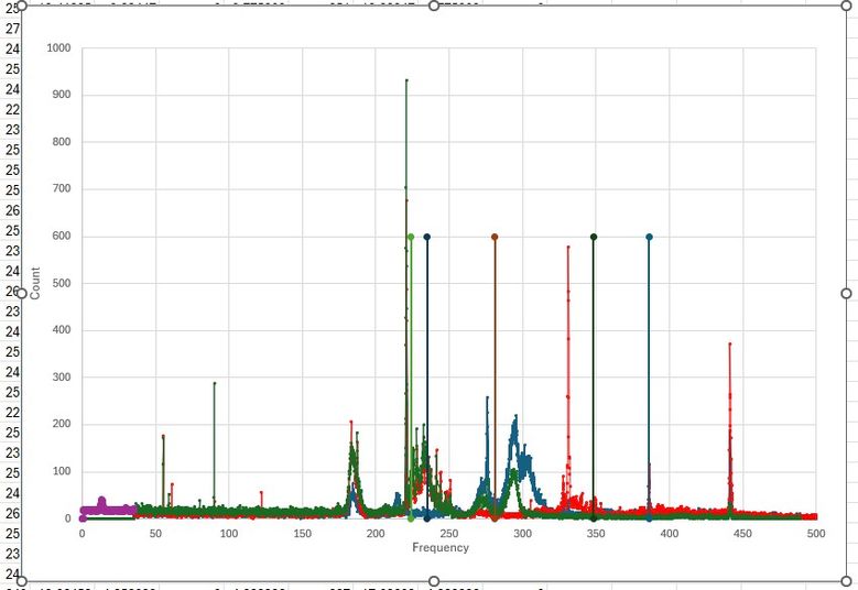

So a single FFT
tells you nothing, from this select the two critical peaks.

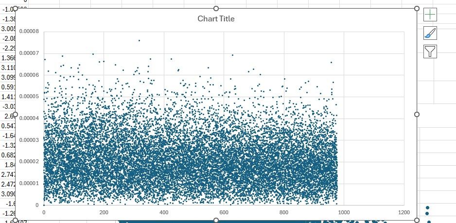

If you add the peaks to a data base eventually you will get this, this shows 8192 frequency steps across about 977 Hz.   From this one notices, that the usual structural frequency range of less than 50 Hz is pretty devoid and even. The minor blip at about 16 Hz is likely the slab vibration. The brick is above 200 Hz.  We cate nothing for the slab, it is just a slab.
This is the XYZ axes, because an engineer will tell you from his limited education that the first mode is probably up and down and that is simply not true, it is true-ish but not true true.
Then you take the FE Model and match the frequencies, which is the large dotted lines. The match is pretty good.
But the FFT is highly scattered on the count.  Is it a temperature variation or something else?

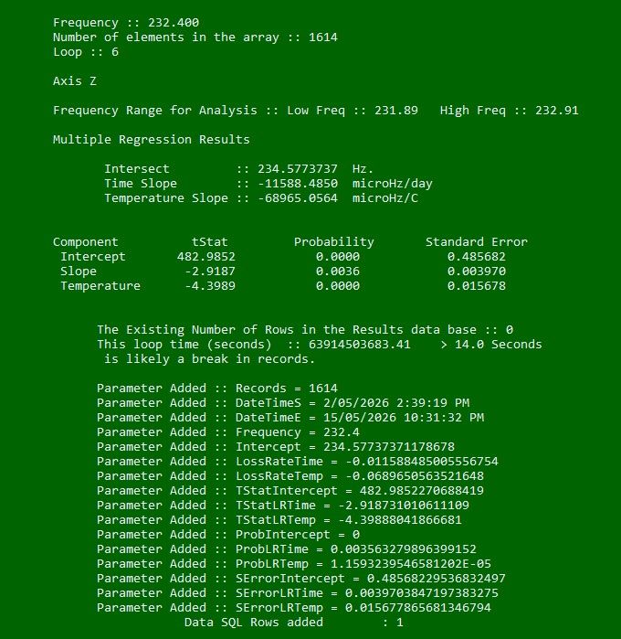

The final analysis looks at the change in frequency with time and temperature assuming, as we know it is, that it is linear or close enough.  We have about ten years of continuous data from a superb machine, sadly not made by ST.  Nor could I use an ST device as it is not evaluation.
So for 232.4 Hz average in the vertical direction looking at a band width of 1 Hz, the loss rate is -11.5 milli Hz per day.  Now the critical feature I have been watching for days is the t Stat essentially it has to be greater than abs(2), it had not been up until now, it was trending but not there.  t Stat is the most important number in civil engineering.
The change in the brick properties is large from temperature but temp has a limited numerical range, so once one gets to about 90 days the time is always dominant,  the brick is degrading quite quickly because it was poorly made and sold in mass.  It might last 20 years if we are lucky. The math to do that analysis is much more challenging and interesting.  And not something we share.
An acceptable number below 30 Hz is 15 micro Hz per day, there is a thousand fold difference.
