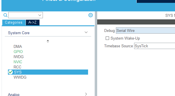

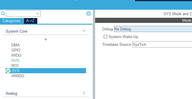

How do you have pins PA14, PA13 setup ?
Debug -> No Debug (then the problem is here)
or
Debug -> Serial Wire
