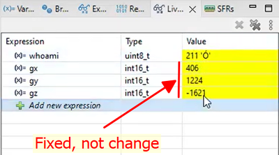

Hi
What does L3GD20_Read_WHOAMI return?
--> It returns 211
When I use
> hspi1.Init.CLKPolarity = SPI_POLARITY_HIGH;
> hspi1.Init.CLKPhase = SPI_PHASE_2EDGE;
The sensor returns only 1 time (then the sensor data does not change anymore)
Do you know the reason why?
Thank you

2025-08-21 9:21 AM
"Try doing a dummy SPI transfer (with CS high) prior to your first SPI transaction, but after SPI is initialized."
-->Wowww. It works. Thank you very much. Could you explain why?
2025-08-21 11:17 AM
The CLK pin is not driven until the peripheral is enabled. On the first transaction, it's low when you set CS low, which messes up the first transfer. Doing a dummy transfer enables the peripheral. See my first reply.
