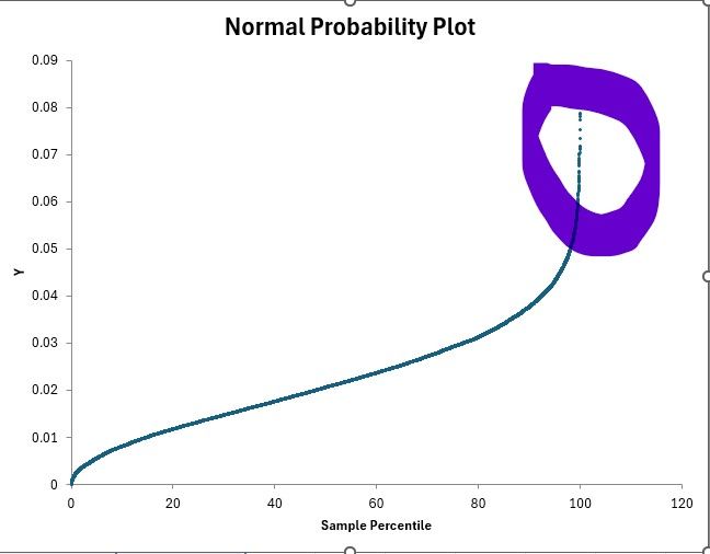

The NPP is as expected, our team lives and dies in the purple region.

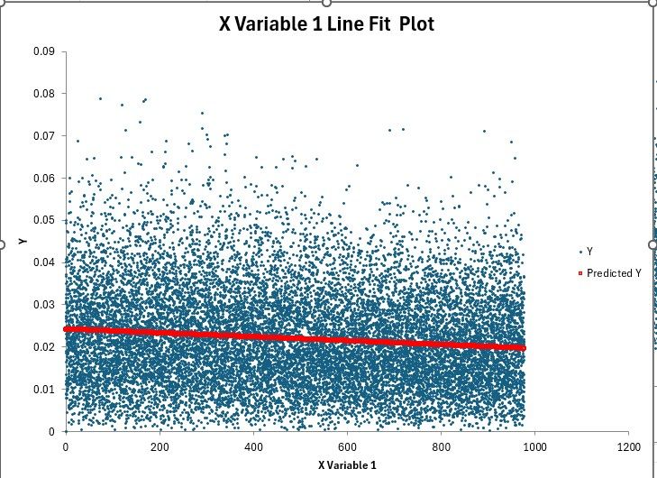

This is a pure a thermal layer as one can get on human earth, without spending a lot of money.  The only thing you can tell from this thermal FFT data is the temperature,  LOL an Iowa engineer who works with me dug a hole in his back yard in the middle of a winter storm and we got the necessary data to ensure that was a correct statement.  He was not amused, I just had to chuckle.   The analysis of the linear regression using EXCEL, shows the line is "a straight line" and the t Stats say it is accurate and the P Values are a waste of time as a modern computer cannot represent the p values from the T Stat, trust me I have tried and failed there, but anything over 2 is ok and and 14 means it is as certain as we get on this earth.
 CoefficientsStandard Errort StatP-valueLower 95%Upper 95%
Intercept0.0242296470.000179833134.734258600.0238771550.024582139
X Variable 1-4.6482E-063.18852E-07-14.577914777.73748E-48-5.27318E-06-4.02321E-06
And we take the 18 days of collected data from the sensor,

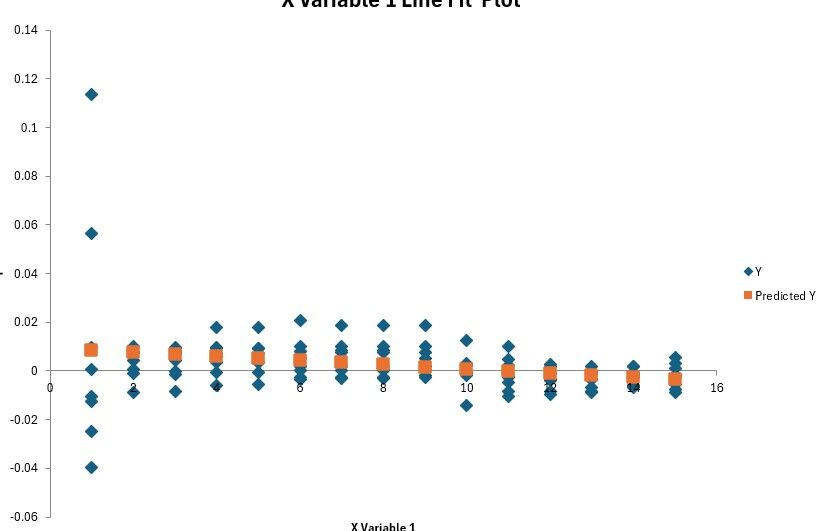

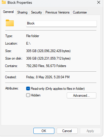

For the X axis - 842.  And my work mate in England, she says garbage and I say wait, it will take time to see if the device is sound.  By the way -842 is not good for the structure but it is just a block under my desk that will sit there and not say a word, unlike my 19 year old daughter who says lots of words.
