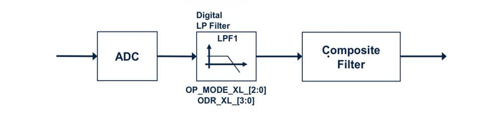

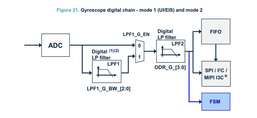

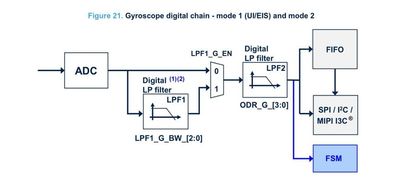

given following blocks from the the datasheet
I would assume that the LPF1 and LPF2 would directly feed into the SFLP at 60HZ each
in static setup the readings seem fairly good with low drift.
However, as soon as I move the IMU a bit and try to come back to the original pose the drift seems much more significant. much more then inaccuracy from placing it correctly again, also there seems to be some jitter in the readings aswell, where the orientation jumps back and forth.
I assume that the way I setup the filter is causing this jitter, as when I run the sensor without the filter it seems more stable.
