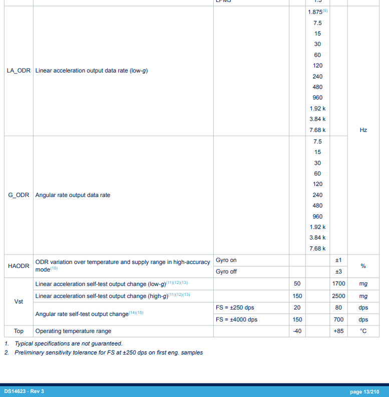

The available data rates are in the datasheet:
https://www.st.com/resource/en/datasheet/lsm6dsv320x.pdf#page=13
The data rate = sampling rate effectively defines the bandwidth.

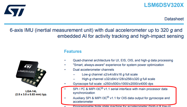

The available interfaces are defined in the datasheet:

Also will sensor integrate with CAN?
