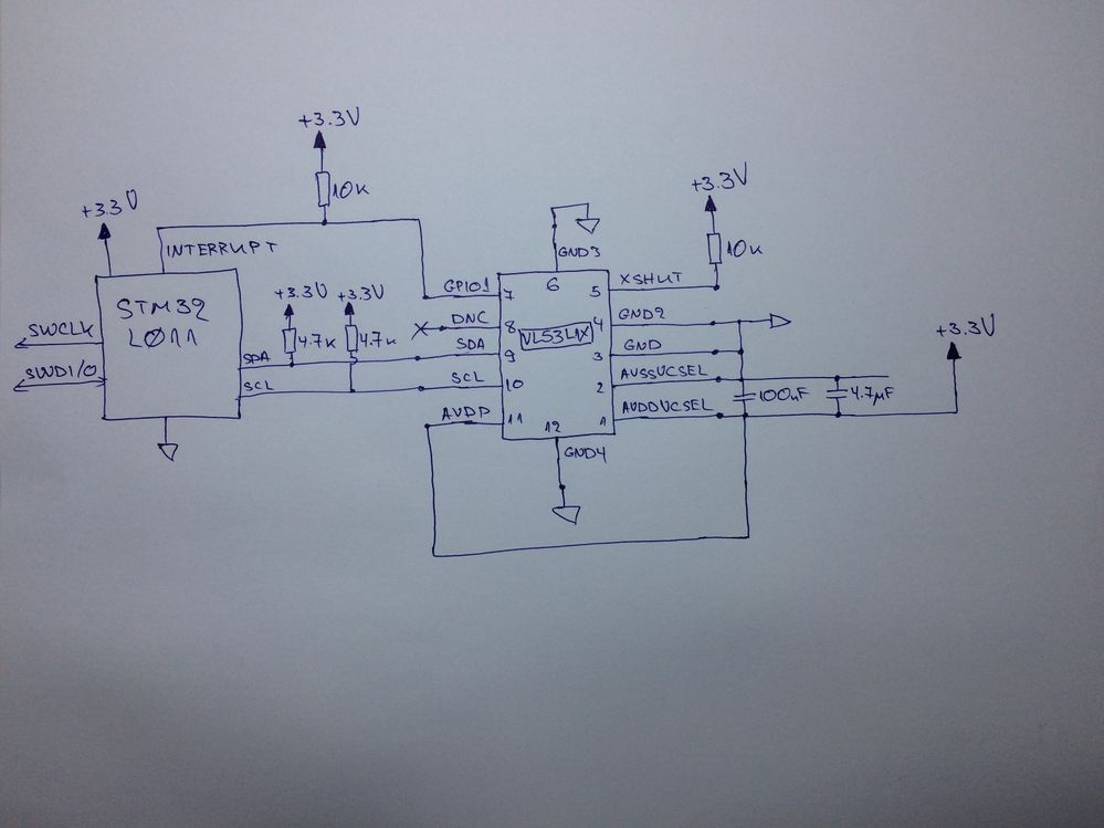

Using STM32L011 uCU, ULD API and LowLevel I2C libraries I am interfacing the sensor AND successfully reading/writing data from/to it. Here is a snippet of my communication to the sensor:

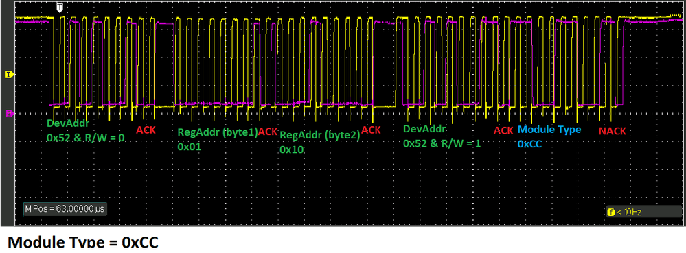

}Here are oscillograms of the I2C bus, for the code above:

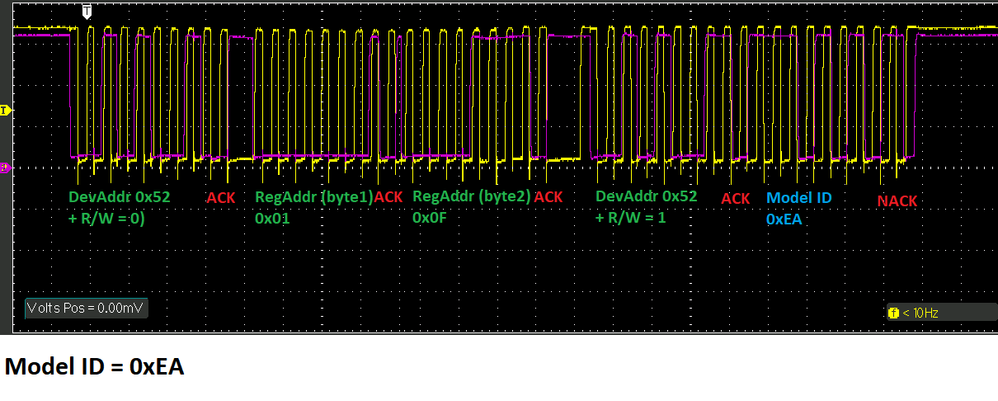

READ Model ID:
READ Module Type:

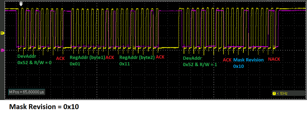

READ Mask Revision:

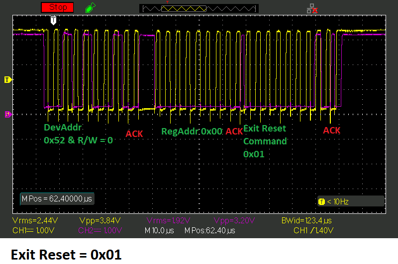

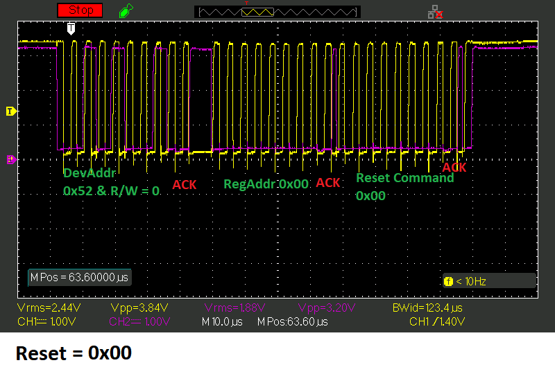

WRITE Enter Reset Command:
WRITE Exit Reset Command:

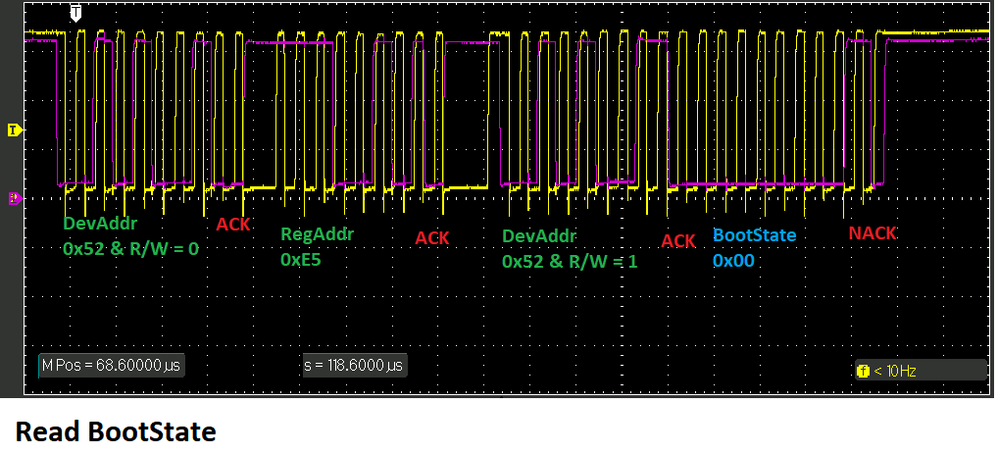

READ Sensor Boot State:
From the oscillograms it is seen that the I2C communication is working.
The issue is that when I read the boot state internal register I am always receiving 0, which means that the device is not booted. This stops me from further device use.

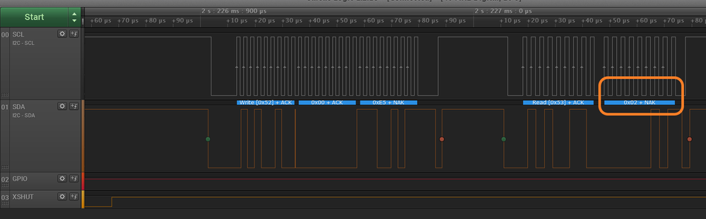

2020-09-14 2:42 AM
Hello.
I have a similar problem with VL53L1X. The difference is that VL53L1X always returns as boot state 0x03.

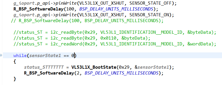

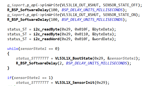

This is my code (I don's use ST's platform):

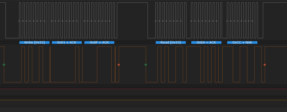

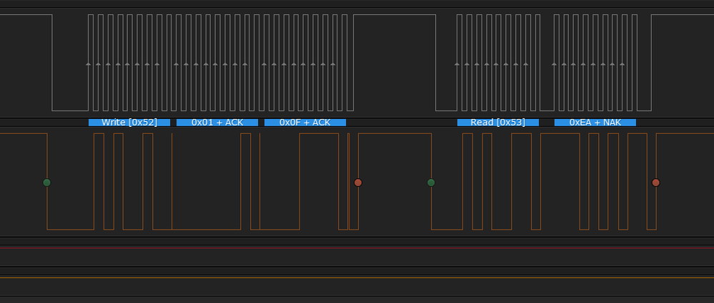

This is what I first read on the bus (chip ID 0xea, 0xcc, etc):

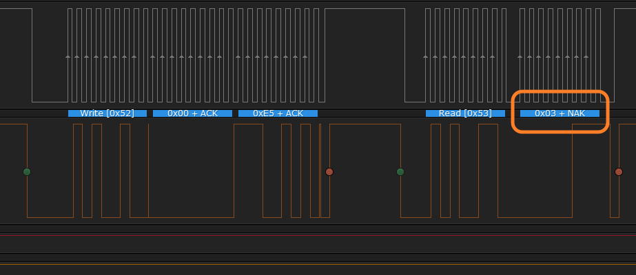

As John says above: 'The fact that you can read the Chip ID means the chip is booted'. However, I get the boot state = 0x03! What does this mean?
Regards
2020-09-14 7:52 AM
The bootstate register spec is:
[1] firmware_first_range: FW first range status
[0] firmware_bootup: FW initial boot status, Set by FW after completing initial coldboot.
I can only conjecture that you called this function after your device was already alive.
Perhaps you restarted your code without first powercycling the sensor?
At initial boot I'd expect a 0x1, then after a range, I'd expect a 0x3.

Hello John, thanks for your quick response.
** I can only conjecture that you called this function after your device was already alive.
I don't think my device is alive because the code I posted above is executed immediatly after initializing I2C, timers and other MCU peripherals.
** Perhaps you restarted your code without first powercycling the sensor?
What exactly do you mean by "powercycling the sensor". I you mean pulling pin XSHUT first OFF and then ON, I do it immediatly before calling "VL53L1X_BootState()" and "i2c_readByte()", as you can see in my code.
Another thing I relized after writing the first post is the 100ms delay I used after XSHUT ON. Not using this delay the device returns bootstate = 0x02. What's the meaning of this?

Hardwariano,
Can I ask that you ask again on a different thread. This one is too long, and "Velizarw's" 'I figured it out' makes a fitting end.
But to answer your question, putting noise on the XShut line is really bad, the chip will start to shutdown, then come back up in a bad state and you have no idea where you are. So drop XSHUT, leave it off for a bit, then bring it back up.
I had problems with this register too. I think the documentation has it backwards.
So boot, read the register quickly, see what it reads a few millisec later, then range. With a little luck it will go from 0 to 2 to 3 after ranging.
