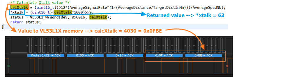

First of all I have to say that the self-calibration of the crosstalk VL53L1X_CalibrateXtalk()) works well (or I think so).
After that correction (16bit register = 0x0fbe --> xtalk = 63 cps), my sensor returns RIGHT measurements.

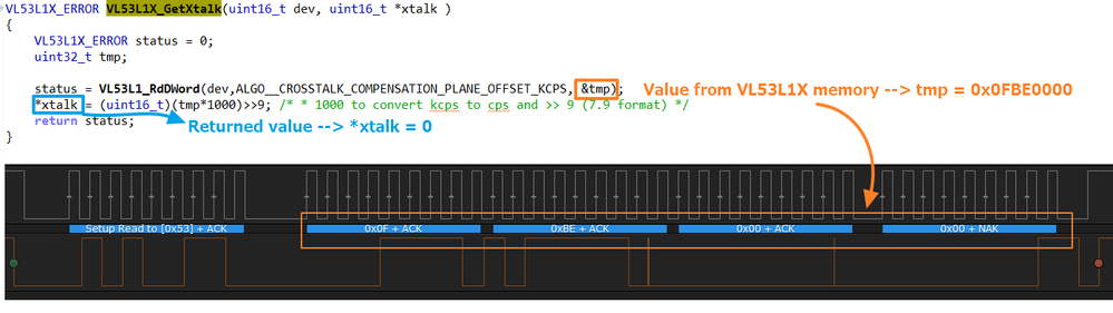

The first issue comes when I try to read crosstalk value stored in internal VL53L1X memory using "VL53L1X_GetXtalk()". I receive 32 bits of data (0x0FBE0000) and this function says xtalk = 0 cps, which is not true because I previously used "VL53L1X_CalibrateXtalk()":
I found 2 solutions to get xtalk = 63 cps. Please, tell me if they are correct:
1) Use "Read Word" (VL53L1_RdWord) instead of "Read Double Word" (VL53L1_RdDWord).
status = VL53L1_RdWord(dev,ALGO__CROSSTALK_COMPENSATION_PLANE_OFFSET_KCPS, &tmp);
*xtalk = (uint16_t)(tmp*1000)>>9; /* * 1000 to convert kcps to cps and >> 9 (7.9 format) */2) Use the original "Read Double Word" (VL53L1_RdDWord) but change right shift from 9 to 25 (16+9). Note the new parentheses to give priority to shifting over casting:
status = VL53L1_RdDWord(dev,ALGO__CROSSTALK_COMPENSATION_PLANE_OFFSET_KCPS, &tmp);
*xtalk = (uint16_t)((tmp*1000)>>25);#################################################

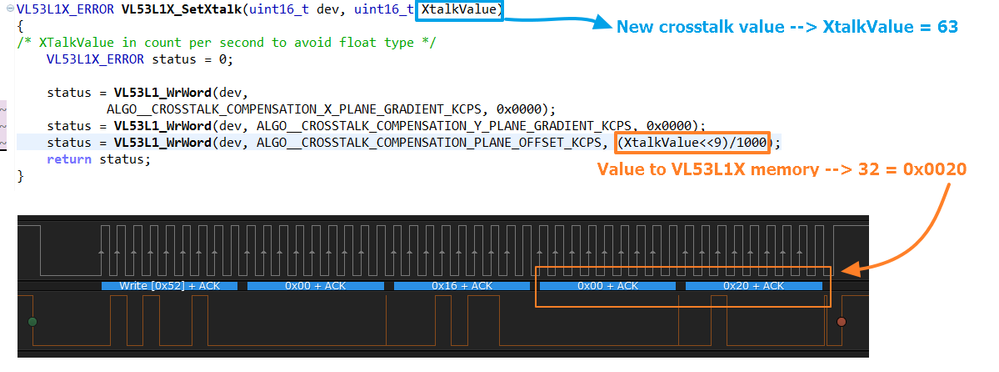

The second issue comes when I try to write manually xtalk = 63 cps using "VL53L1X_SetXtalk()":
After that operation (xtalk<<9/1000), xtalk = 63 cps is converted into 16bit register = 0x0020. Sending 0x0020 causes my sensor to return INCORRECT measurements.
I know 16bit register = 0x0020 is incorrect because if I send 16bit register = 0x0fbe (previosly calculated by "VL53L1X_CalibrateXtalk()", as I explained at the beginning of this thread), my sensor works well again.

################## VL53L1X_GetXtalk #################
This is the original code:
*xtalk = (uint16_t)(tmp*1000)>>9;This is my code:
*xtalk = (uint16_t)((tmp*1000)>>25);Changes:
1) I replace a 9 with a 25 because, otherwise, the result of the reading is always 0, as I explained in my previous post.
2) I add parentheses for bit shifting to be done before casting to uint16. This may not be a problem for ST microcontrollers, but it is a problem for the microcontrolers I am using. This gave me a lot of headaches until I figured it out.

status = VL53L1_WrWord(dev, ALGO__CROSSTALK_COMPENSATION_PLANE_OFFSET_KCPS, (XtalkValue<<9)/1000);
/* * << 9 (7.9 format) and /1000 to convert cps to kpcs */This is my code:
status = VL53L1_WrWord(dev, ALGO__CROSSTALK_COMPENSATION_PLANE_OFFSET_KCPS,(uint16_t)((XtalkValue<<9)/1000));
/* * << 9 (7.9 format) and /1000 to convert cps to kpcs */Changes:
1) Casting to uint16
2) I add parentheses for the same reason I explained for VL53L1X_GetXtalk.
