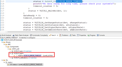

1. 'VL53L1X_ERROR_TIMEOUT' undeclared (first use in this function); did you mean 'HAL_DMA_ERROR_TIMEOUT'?

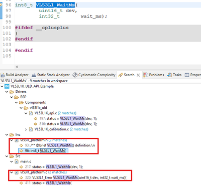

2. implicit declaration of function 'VL53L1_WaitMs' [-Wimplicit-function-declaration]
I have checked the driver files but cannot find their declarations.
I have not changed any of the driver files. Am I missing something? Any help is appreciated. Thank you!

and I also check VL53L1X_ERROR_TIMEOUT is declared in VL53L1X_api.h. we add this timeout just for make sure sensor can't stuck here by some unstable environment (for instance, if a cable or a sensor breaks for some reason).
In addition, VL53L1_WaitMs , there is no problem with the function declaration and definition.
you can download a new one from www.st.com and try again, make sure the version is 3.5.5.
