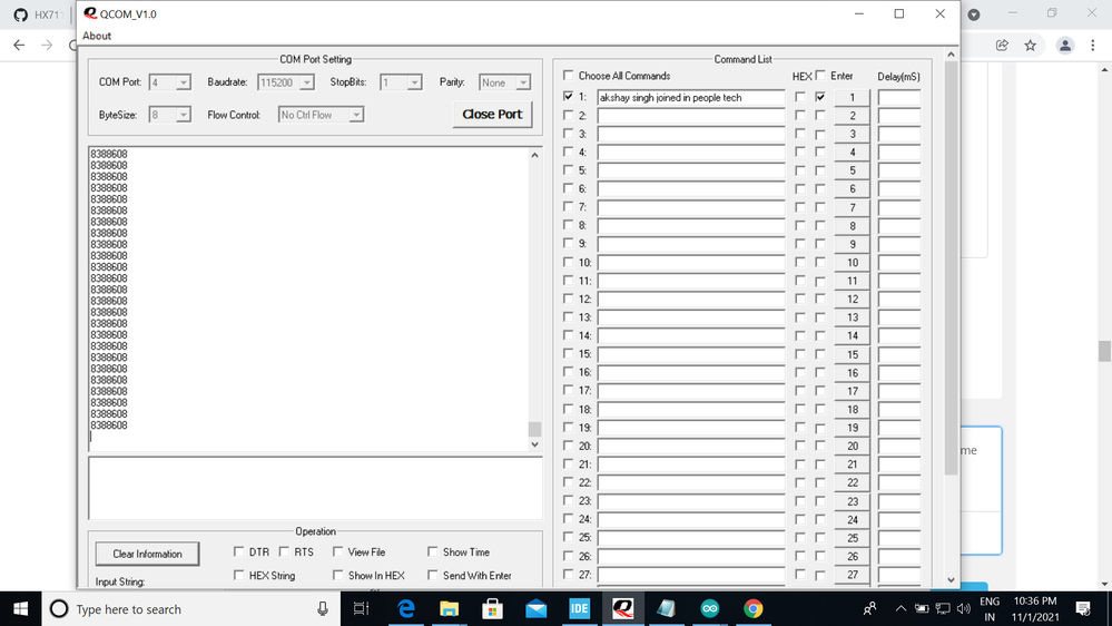

2021-11-01 10:37 PM
hi sir i am getting same value when i increased the load also it will not change why i dont know please give me some idea about that
