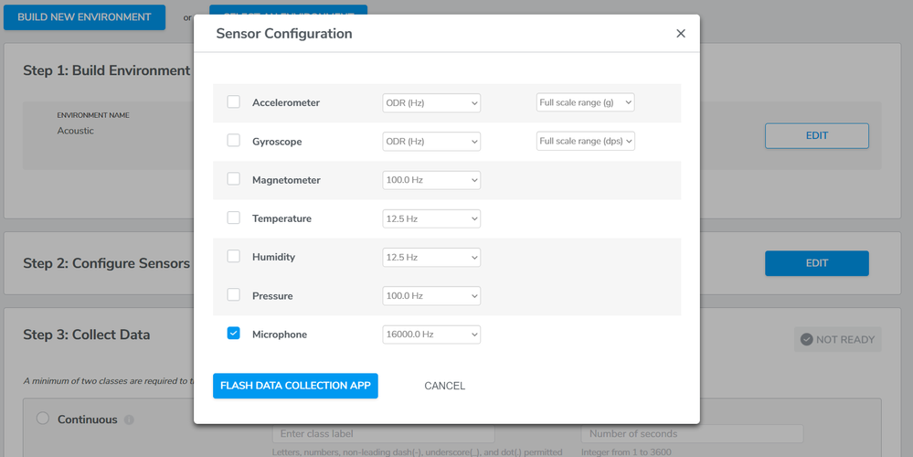

Another possible solution, directly involving the Sensortile.box tool, can be use the Qeexo ML tool: this allows you to run many kind of neural networks on the audio acquisition from the analog MEMS microphone on the Sensortile.box tool.
