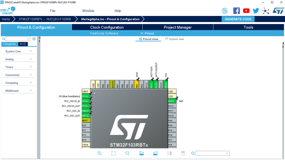

Of course,
I use CubeMX to configurate the pins as u can see in the first picture.
And here is my code:
