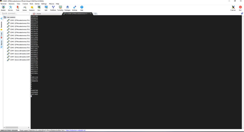

}So now I'am finally getting back something else than 8388608 but they are still random numbers for some reason.

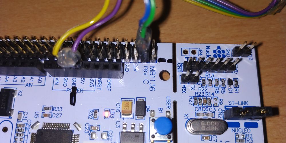

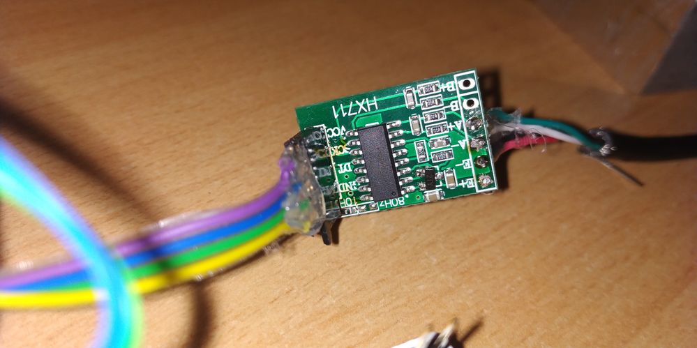

Here is my setup:
