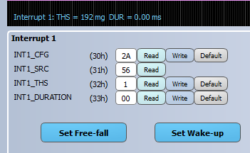

and if I put the 0x01 int the INT1_THS with my bread board and unico I have 192mg
What's the correct value?

2018-05-03 2:48 AM
The correct value of 1LSB threshold fro FS = 16G is 186mg. The sensor has different sensitivity in case of 16g range.

2019-04-12 2:41 AM
The software is UNICO from ST. This is a usefull software for test the ST devise as MEMS sensor.
