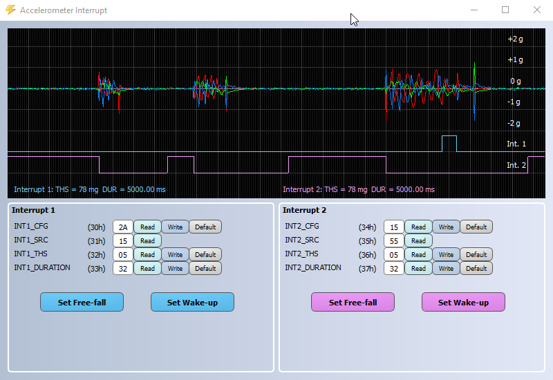

Please see below my configuration, it seems to me it works well.

I have increased the detection threshold for interrupts 1 & 2, from 0x02 to 0x05, and the operation is stable now.
I need also support for the high pass filter, it's not clear for me. The goal of the high pass filter is to delete the continus value on the Z axe (-1g).
If I walk with the sensor on my hand with the last setting, the values of the X,Y and Z axes will be not constant, the values will move from -500mg to 500mg, and the mean value is around 0g. So according to the sample frequency ODR, it's possible to have a low value, under the threshold INT1_THS. so if I put 0x32 for INT1_DURATION and only one point is under the threshold, what's about the INT1_output ? is it set or not set?
Does the high pass filter have action for the case of detection? What's will be the best filter mode for this situation?.

If even only one sample will be under the threshold the interrupt won't be triggered, basically in your case each sample bellow the threshold will reset the duration counter. I don't know what is your exact target, but usually these detections are not 100% accurate, the threshold is different for each activity like for example working on PC, walking, sitting in car, ... and it can vary person by person, also it depends on the position of the sensor (on wrist, in pocket, ...)
STEVAL-MKI109V2 or STEVAL-MKI109V3 cooperate with Unico application, which is able to record data and store them into text file. 15 minutes is not a problem.

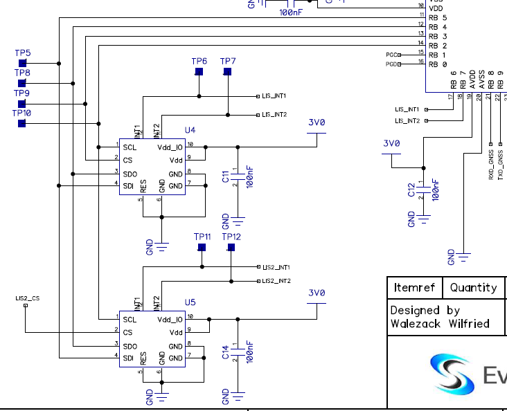

But I have a strange running on the SPI bus when I use 2 LIS2DH,
When I connect and use only one LIS2DH, all are OK, but on my final board I have 2 LIS2DH connected to the same SPI bus. I drive the CS pin on each sensor for set parameters on the selected sensor.
I can't write the value 0x32 into the register LIS3DH_INT1_DURATION(0x33), when I read after the write operation the value is 0xFF. I have no problem with the value 0x31 and 0x33, but only with the value 0x32.
If I disconnect the 2nd LIS2DH, the writing operation is OK with the value 0x32.
I checked my schematic (see below). All it's OK.
Is very crazy, I havn't explanation. Do you I have an idea?
thanks a lot for your support!
wilfried
2018-02-21 12:35 PM
I think, I have an explantion, the second sensor which has CS=1 is actually expecting I2C command and the 0x32 is write address of the sensor on I2C bus. So it interract with your SPI comunication. Can you please capture the comunication on the SPI bus by scope or logic analyzer? You should not create I2C start condition with the SPI communication.
