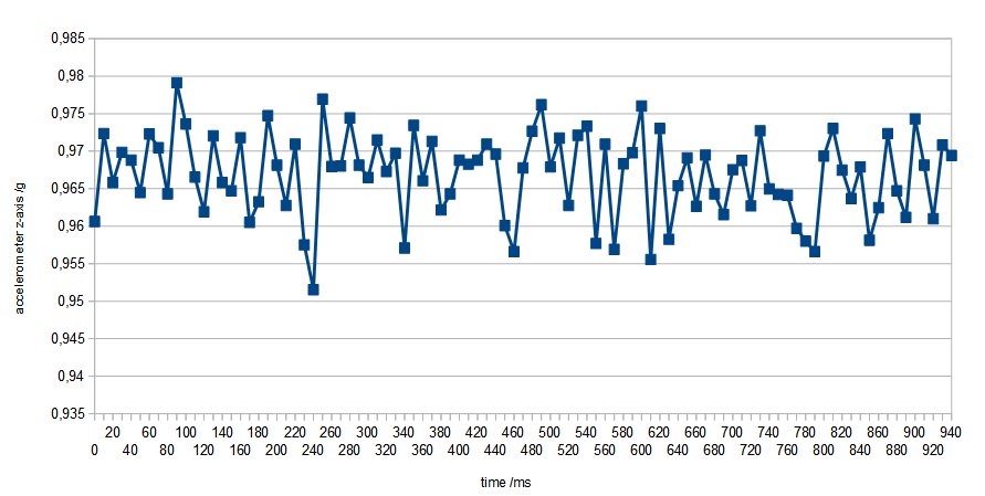

I am using the LSM9DS0, and have observed a lot of noise on the z-Axis of the Accelerometer Data. The attached picture is a plot showing the noise while operating at 100Hz in the +-2g range. Is this a normal level of noise for this device, or am I doing something wrong, or is the device defective?

can you please share the values in text form or attach an excel file, so I can check it.
2017-01-18 3:20 AM
Hello Miroslav,
sure, no problem. here is the values in text form:
0,9606323242
0,97235107420,96582031250,96984863280,96881103520,96447753910,97229003910,97045898440,96429443360,97912597660,97363281250,96655273440,96191406250,97204589840,96582031250,96472167970,97180175780,96051025390,96325683590,97473144530,96813964840,96276855470,97094726560,95751953130,95153808590,97692871090,9679565430,96801757810,97442626950,96813964840,96649169920,9714965820,96728515630,96972656250,95709228520,9734497070,96606445310,97131347660,96215820310,96429443360,96881103520,96826171880,96881103520,97094726560,96960449220,96008300780,95660400390,96777343750,972656250,97619628910,96789550780,97174072270,96276855470,97210693360,97332763670,95770263670,97094726560,95690917970,96832275390,96978759770,97601318360,95556640630,97302246090,95825195310,96539306640,96911621090,96264648440,96948242190,96429443360,96154785160,96752929690,968750,96270751950,97271728520,96496582030,96423339840,96411132810,95971679690,95800781250,95660400390,96936035160,97302246090,96746826170,9636840820,96789550780,95812988280,96246337890,97235107420,96472167970,96118164060,97430419920,96813964840,96099853520,97082519530,96942138672017-01-22 4:41 AM

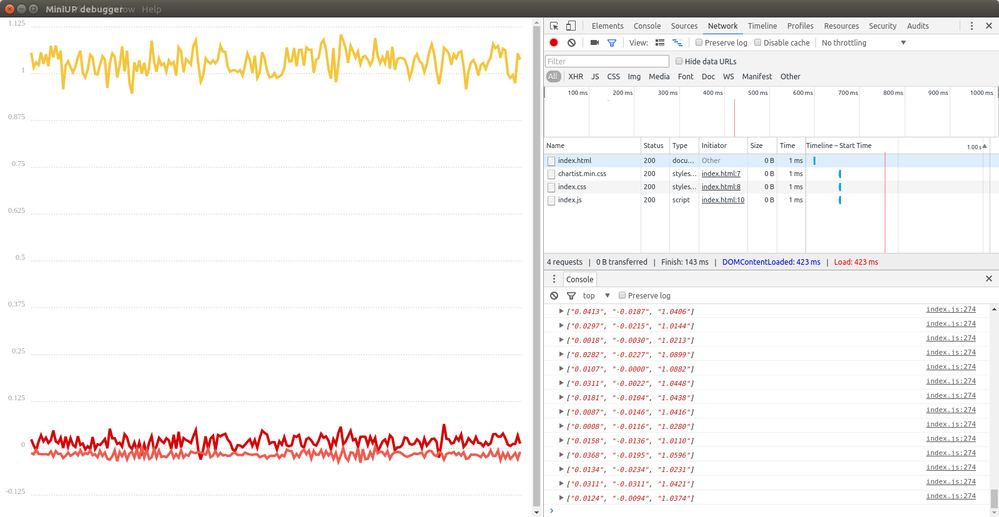

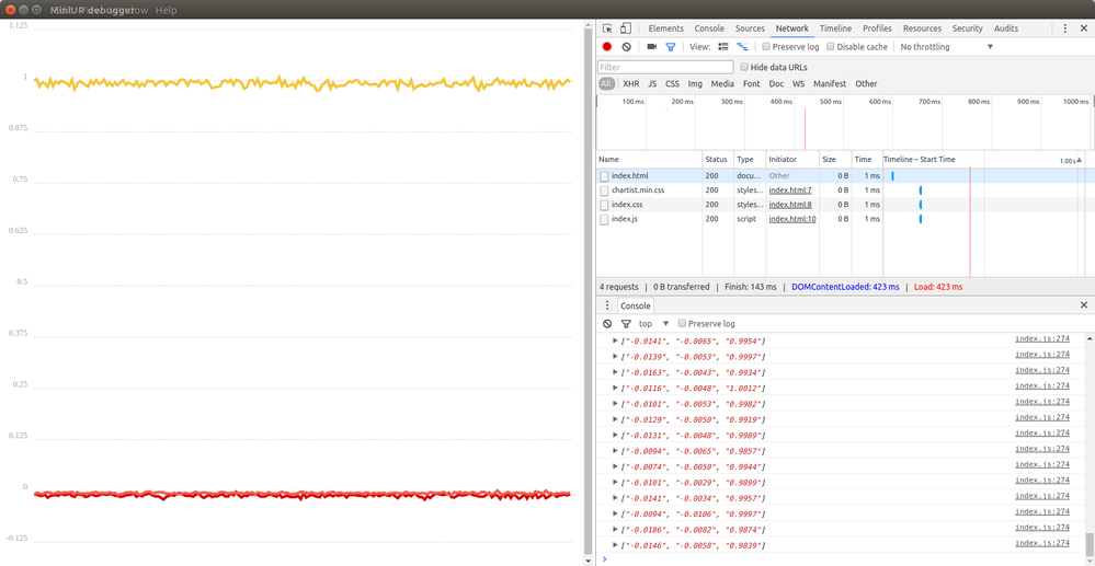

,I have the same issue as Erich, in fact I can confirm, that some of the devices using this sensor does not have any noise or should I say there is expected noise and the other devices have the same noise as presented by Erich. Ihave tried 10 different sensors and at least every second device has this noise issue.
Pictures from the one without the noise and the one with noise below.

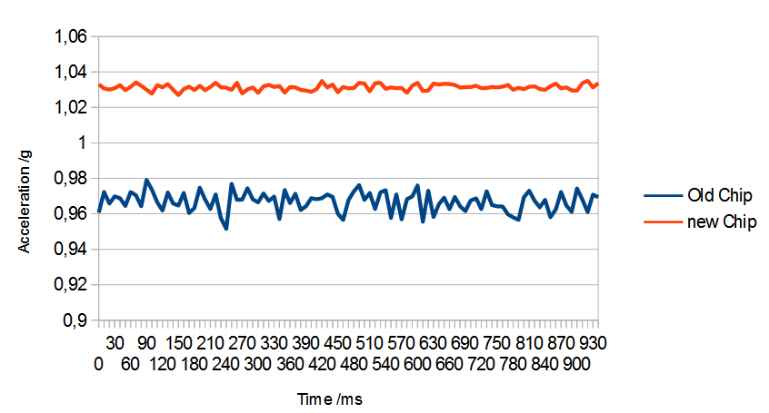

I have checked the Supply voltage and blocking capacitor, have switched to using the data_ready to trigger the readout of the chip and checked for vibration being mistaken as noise. these measures did not help.
then we replaced the chip with a new one, and the noise is much lower, as seen in this image:

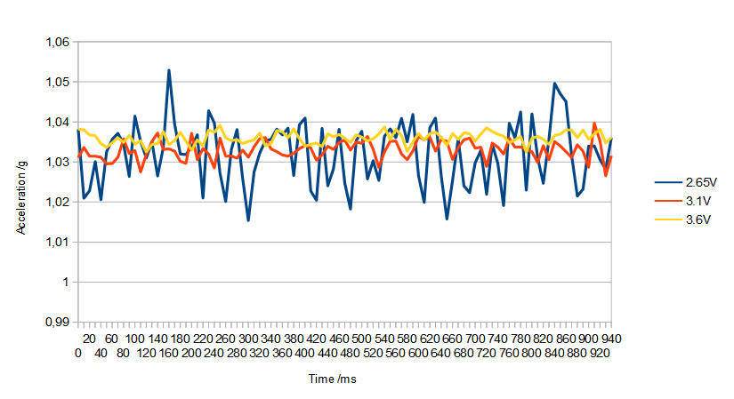

I also observed that the noise level is highly dependent on the supply voltage, as seen in the following image. is this normal?

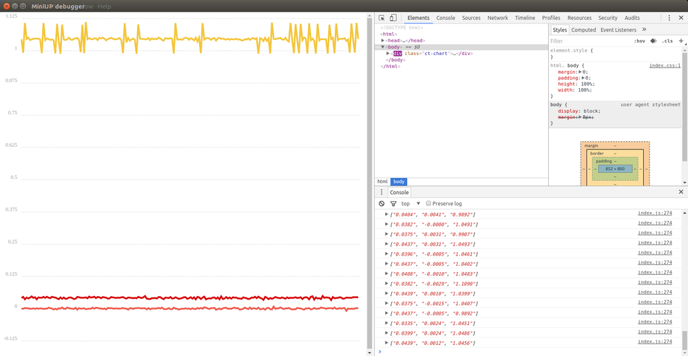

thank you for the data, I discussed the issue with my colleagues, unfortunately they never had this kind of problem with LSM9DS0.I got only one advice to check that the Block Data Updated (BDU) is enabled (in CTRL_REG1_XM register).2017-02-02 2:40 PM
Batek.Miroslav
Looks like we might get this chip to work properly. We took your advice and set BDU onCTRL_REG1_XM and you can see the improvement on the image below.
neumann.erich
this is something you should also try.I have some other questions if you can help me out.
