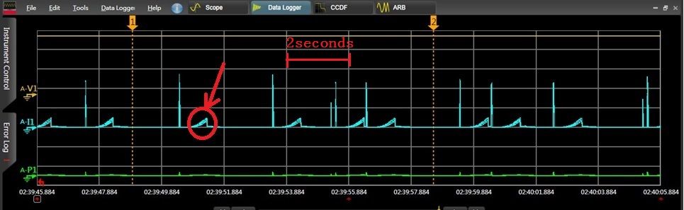

   We are developing a ultra low power sensor module with the LSM303D. The LSM303D was periodically waken up to take a  magnetic and temperature measure (no acceleration measurment). The total excepted average current is <100uA, but the acture current is >300uA which was unacceptable.
   The following picture was snapped from the oscilloscope measuring the module's current. The narrow pulse current were caused by the module's periodically magnetic and temperature measuring activity. But the ramp shape pulses were unexpected. Sicne these ramp-pulse lasts for hundreds of miniseconds each, the total current was dramatically increased.
   The questions is:
   Are these ramp-pules current normal for the LSM303D?

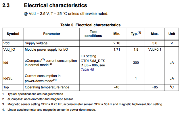

According to the datasheet the 300uA is typical current consumption.
See Table 5. below.
How did you get your estimation 100uA ?
I suppose the ramp-pulses are caused by demagnetization of the magnetic sensor for each measurement to improve the accuracy.
