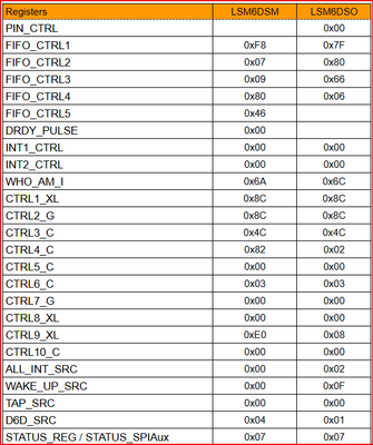

I'm currently migrating from LSM6DSM to LSM6DSO in my application and facing some issues with accelerometer accuracy in stable conditions.
MCU: STM32L4
Sensor Interface: SPI (3-wire)
Purpose: Reading raw accelerometer and gyroscope data, converting to physical units, and estimating roll/pitch/yaw using MotionFX.
| Acc/Gyro ODR | 1.6 kHz |
| FIFO Output Rate | 400 Hz |
| Main Loop Rate | 100 Hz |
| Averaging | 4 samples/frame |
I can successfully communicate with LSM6DSO via 3-wire SPI.
I’m able to read raw data from the accelerometer and gyroscope.
Sensor fusion (MotionFX) works and outputs roll, pitch, and yaw.
I'm trying to measure raw linear acceleration (after converting to g).
The requirement is that the noise level (in a static, stable condition) should be less than ±0.005g in all directions.
With LSM6DSO, the data seems noisier and less accurate, even though I'm using the same processing and averaging method.
The Register Configuration of LSM6DSM and LSM6DSO -

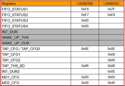

Hi @rshar.21 ,
Are the testing environment and the board design the same for the two products?
2025-07-28 1:09 PM
Hi @Federica Bossi ,
Yes, both have same board and firmware. The only change I can say is the way I read the data in firmware. Do you see any issue in the way I'm reading the data(code snippet I have attached above).
2025-08-11 5:23 AM
I'm attaching the screen record of RAW Gyroscope data of both LSM6DSM and LSM6DSO. In the video if you see, LSM6DSO have very big difference compare to the LSM6DSM raw data values.
https://drive.google.com/file/d/1YMZNImJY30xT1jEa3pBw5PN0X9XdD6PT/view?usp=sharing
NOTE - LSM6DSM Data is in the left side, LMS6DSO is in the Right side.
Do you see any reason to have this much difference in LSM6DSO values even they both are kept in same bench and in static condition.
