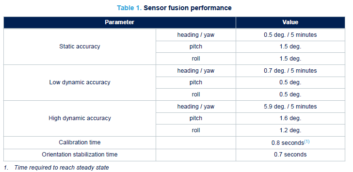

In LSM6DSV16X DS13510-Rev 4 Page 8, Table lists sensor fusion performance:
Question 1: are these values guaranteed over temperature and all angles, or at a particular angle and at room temperature?
Question 2: without a magnetometer or GNSS heading input, what is meant by heading/yaw accuracy? Is it a drift value (over 5 minutes) from whatever value it is given at the beginning of 5 minutes?
Thank you.

With accel and gyro only, yaw/heading is relative only and subject to drift. After any significant motion the heading will change and become essentially arbitrary. It really cannot be relied on for absolute orientation estimation. However, the roll and pitch are likely to be as accurate as quoted or better (~1 degree) with proper accel/gyro calibration and repeatable even after significant motion, which is still very useful.

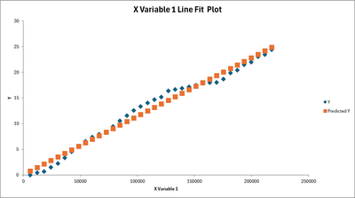

As I was looking at the LSM6DSV16X on the Sensor Tile Box pro.  The timing in the output files shows
A linear regression with reasonable accuracy and an added Fourier Series error.  I have only done one test.
I should be able to find the FFT results in the overall FFT.  I will look sometime in the future.
This is 19.1 seconds.
