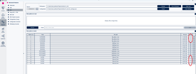

After collecting all samples in .csv format, I have then proceeded to Advanced Features -> MLC and uploaded all collected .CSV data using different class names. See the below:
I noticed that STATIONARY and SHAKING samples have the Time option, but the FLIP_DOWN and FLIP_UP samples do not, even though all samples were collected one right after the other using the same accelerometer configuration and same setup.
As a result of that, I cannot proceed to the ARFF generation:
I tried to look at MEMS Studio tutorials and tried to look up information about this, but cannot find anything.
1. What does this "Time" option mean in Data patterns table? I have read datasheet for the Mems Studio but could not find any relevant information regarding this. https://www.st.com/resource/en/user_manual/um3233-getting-started-with-memsstudio-stmicroelectronics.pdf
2. What could have caused my "flip_down" and "flip_up" samples that I have collected be somehow different than "stationary" and "shaking"? How am I supposed to proceed with MLC if I cannot do that?

Hi @LPetr.1
The issue you reported is related to the handling of the special character _ in the label column of the CSV file.
In the current version, labels containing _ may not be processed correctly by MEMS Studio, which can cause the Time option to appear inconsistently in the Data Patterns table and block the ARFF generation step.
This will be fixed in the next version, where the _ character will be handled properly.
Workaround: please update the labels in your CSV files to avoid the _ character. For example, instead of:
use:
After updating the labels, the issue should no longer occur and you should be able to proceed with MLC and ARFF generation normally.
